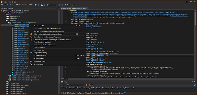

The Avalon 6 dll is upgrade friendly. But the Custom Code Editor is only minor-version upgrade friendly.
There was a .xml with styles in the Client folder, but that did nothing.
I had to use a Hex Editor to modify the xaml inside the dll and rebuild it. It was merely a .resource file being modified, easy to replicate. But its compiled for 10.2.700 so you would have to patch 2021.1, 2021.2 etc all seperately.
If you are on 10.2.700 for now, let me know in pm I can send you the 2 dll’s to replace in your “client folder”. But I don’t plan to build this or maintain this.
We can make an Epicor Idea for it, the change took me 15 minutes with Hex Editing, it will take Epicor 2 minutes to do it… but 3yrs to get it approved. :slight_smile:

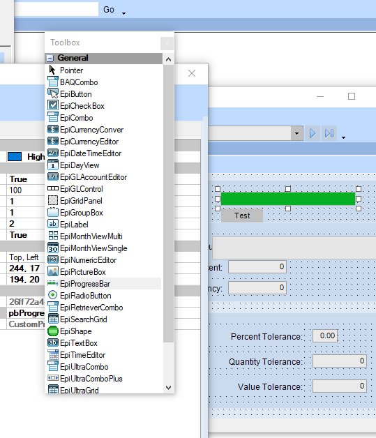

Not as big of a Wizard as @josecgomez who makes his own Toolbox Elements :stuck_out_tongue:
If you need a progress bar, dm Jose… @Hari_Dutt

It’s just Client Side Dlls. So it will work for Cloud too.
You, @utaylor and @Mark_Wonsil will have to wait for a LinkedIn Article.

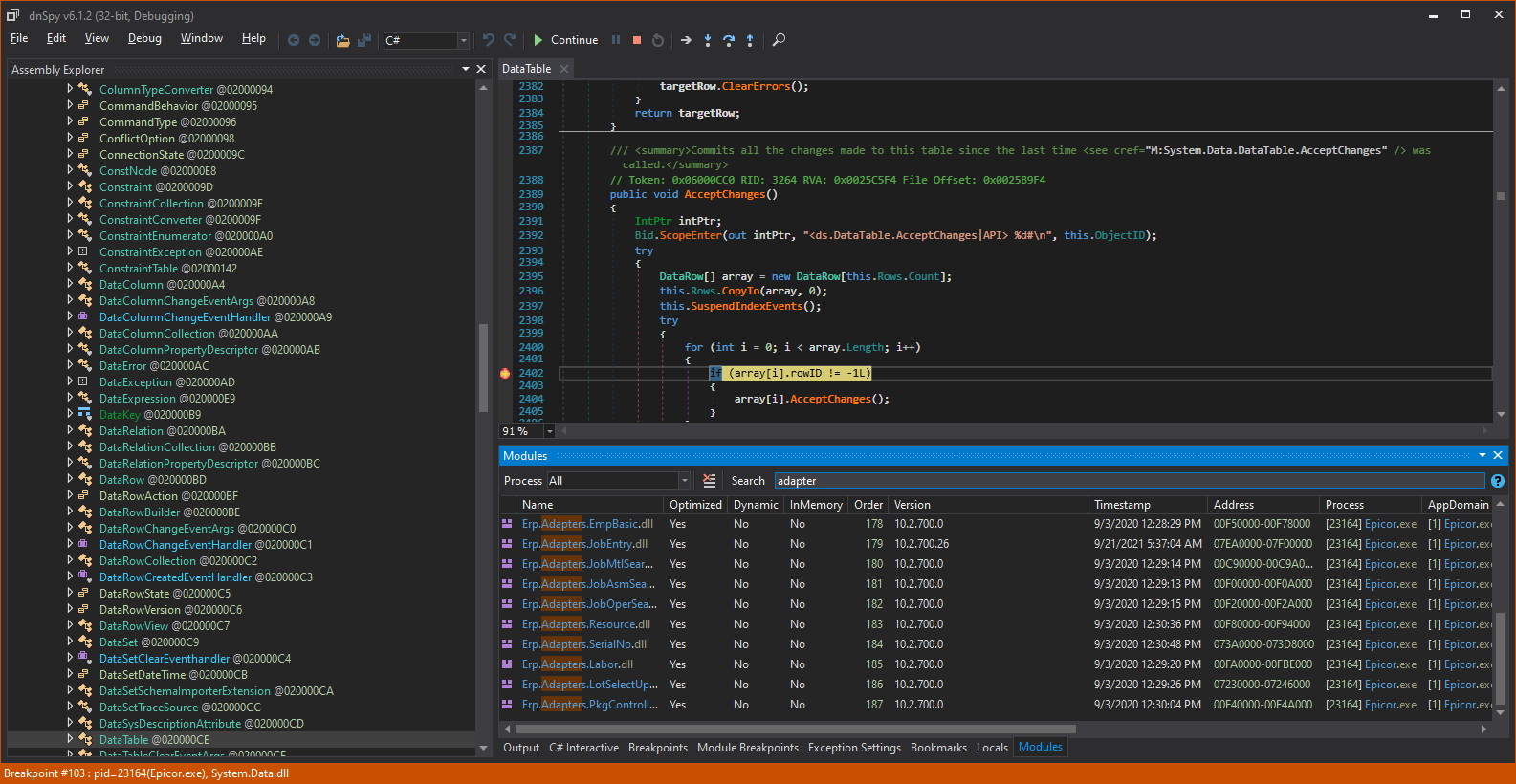

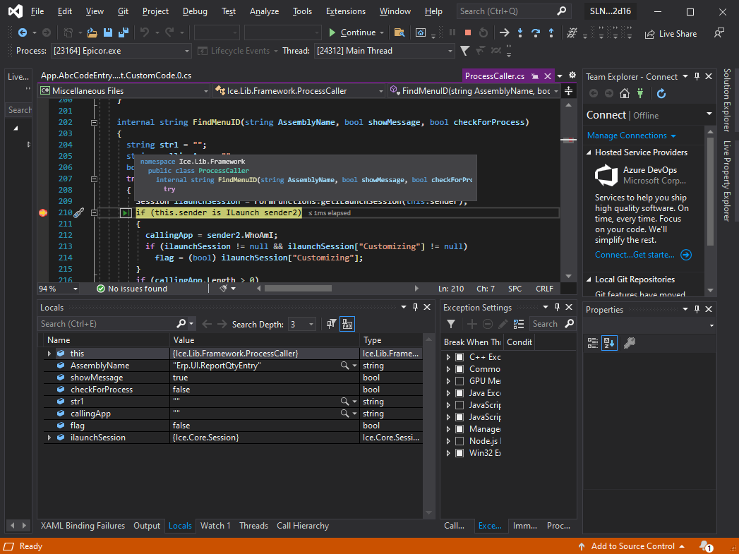

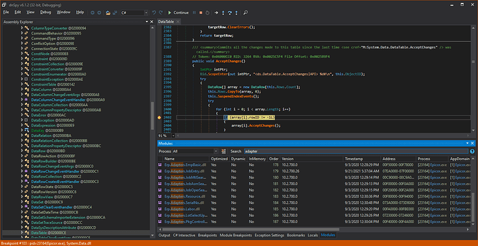

There are plenty of Assembly Editor’s out there. The favorite is dnSpyEx (actually that one lets you debug a process and put a breakpoint on ANYTHING Epicor, not just your Customizations).
Obviously I dont edit much, unless its a HOT HOT HOT Bug and we cant wait. But Mainly I use it to Debug.
But first I need to write an article on how to Step into Epicor Code while you Debug your Customization.
Looking forward to it @hkeric.wci
:warning: Never use in Prod because a break there stops everybody!!!
Well I dont necessarily debug Server Side… only Client Side :slight_smile:
