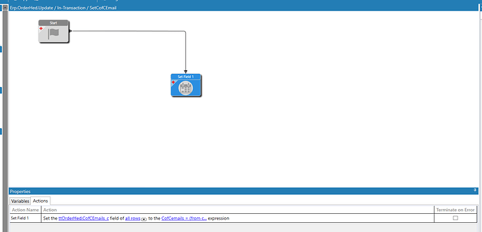

I have an in transaction data directive setup on the OrderHed table that is running the code below to pull back some email addresses we have saved in a UD field on Customer. The problem is that this will work for some customers when creating orders but not all and I haven’t been able to find a pattern. I’ve tried moving this to a method directive and it still does not work. My end goal (which I do have setup) is to have a routing rule on the pack slip print that emails out an additional report without user interaction.

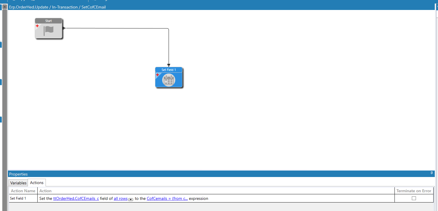

I have tried changing the Set XX field for All Rows to only the added row, and the updated row, and neither seems to make a difference. If anyone has any guidance on things to try, I am all ears.
CofCemails = (from c in Db.Customer where c.CustNum == ttOrderHedRow.CustNum select c.CofCEmails_c).FirstOrDefault()
Here are the specifics of the directive, just a start widget and a set field widget
It’s probably coming back null.
Add some checks and log it somewhere.
Remove the equal from there, I may have it wrong but that returns either true or false.
Instead of
Use
Any chance the OrderHed.Update BO isn’t getting triggered? When it’s not firing, can you recreate in your test environment? Is it customer-specific?
Turn on trace logging with BPM’s checked for a sales person, and then crawl through the logs after you’ve found a case where it’s missing.
Andris you were right. I moved this to OnCustomerChange BO and now it is working.
