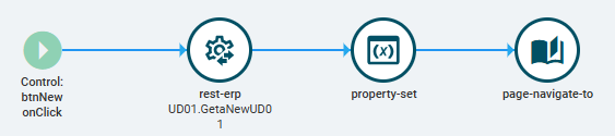

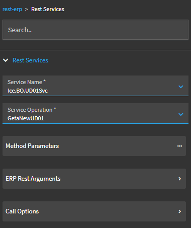

For the new button I have an event that uses rest-erp and navigates user to Details page.
Here is how I do it and what issues I have:
I have a dataview called UD01 that I have created using DataView Guided setup with source type: BO Service Call, source type: Ice.BO.UD01Svc and Method: GetByID.
For response parameters I have selected UD01
For the btnNew event, I have the following widgets:

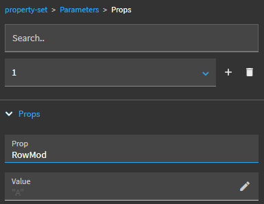

For the property-set, I am trying to set RowMod=‘A’ using the prop property:
The Value is JSON format (Not sure if my format is correct):

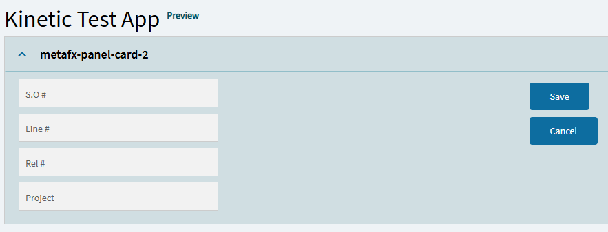

When I click New, I get redirected to the details page where I have 4 text boxes:
As you can see the controls are all greyed out. Their EPBindng are set to fields coming from UD01 view.
1- Why are the fields greyed out and how do I fix that?
2- When I click save, I see no error message!

Fair enough. When you preview your app, before you hit the new button, turn on dev tools in your browser (F12) and then click somewhere in the whitespace of your app and hit Ctrl+Alt+8 to turn on the console logging.
Once that’s done click your new button. The Console tab of the dev tools will show you if your event is firing correctly, and the network tab will show you what calls are being made and what’s being received.
You can also click on the whitespace of your app and hit Ctrl+Alt+v to see all of the dataviews and what’s in them. If you successfully got a new UD01 record your UD01 view should be red to indicate it’s a dirty view with unsaved changes. Come back with the results from that and we can troubleshoot more.

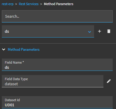

Well without seeing that info it’s hard to say what you’re missing to get it done. Grayed out fields usually point to an empty dataview. I suspect you don’t have anything setup in ERP Rest Arguments>Response parameters telling it to put the results in your UD01 dataview, but it could also be that there’s something wrong with your Method Parameters and the server isn’t returning a new row at all.
