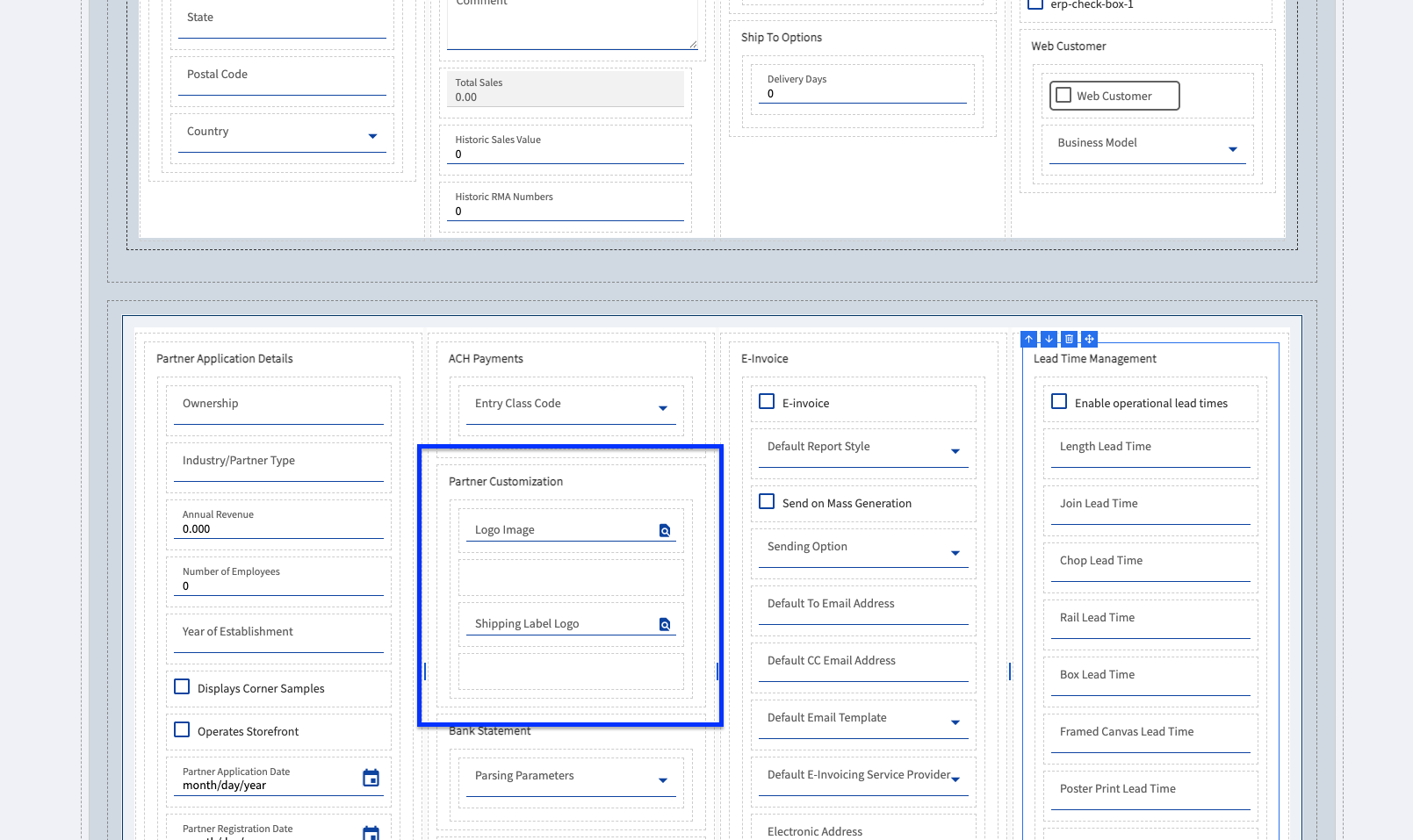

My goal is to add a simple erp-file-box to the Customer screen and have it render in a box below it:

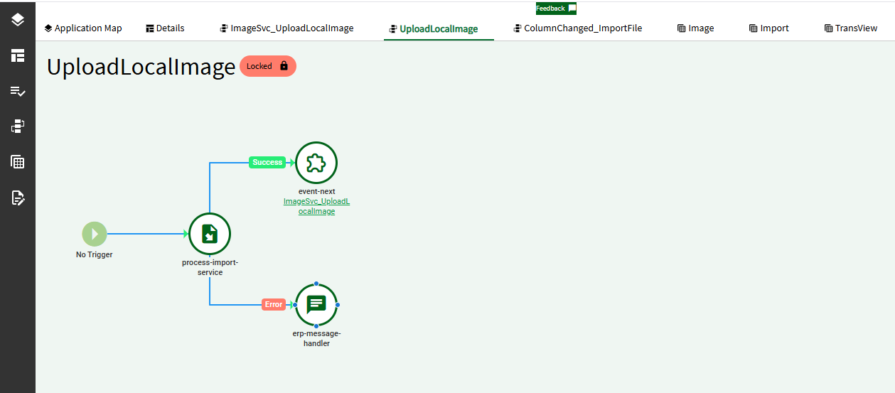

You can do both. Take a look at the ImageEntry in AppStudio. It’s a better example of how to upload than Company Logo.

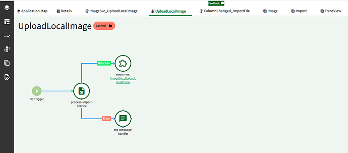

@jbooker so I replicated how a Part Image works and I can get the search open, image selected and input changed in the field.
What I’m now struggling with is the picture box refreshing to actually load the relevant image. What actually tells the picture box to refresh itself to load the image content?
I have the picture boxes mapped to the exactly value of the fields. When they are populated they appear like so:

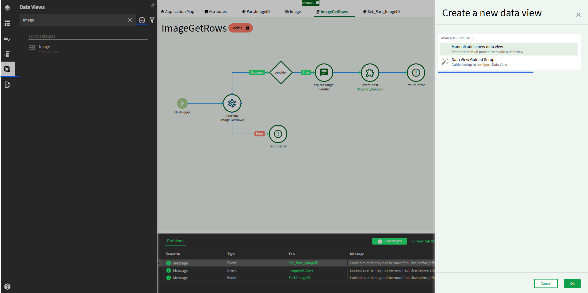

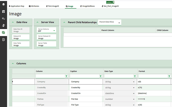

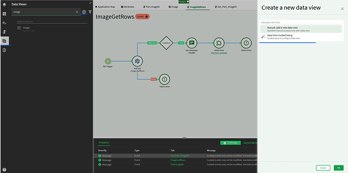

Hey Dave, Nice job! You need a dataview called Image based on Erp.BO.ImageSvc.
You can probably generate this with the Dataview Guided Setup
It may even create the ImageGetRows rest-erp events needed to get by ImageID and populate your image row.

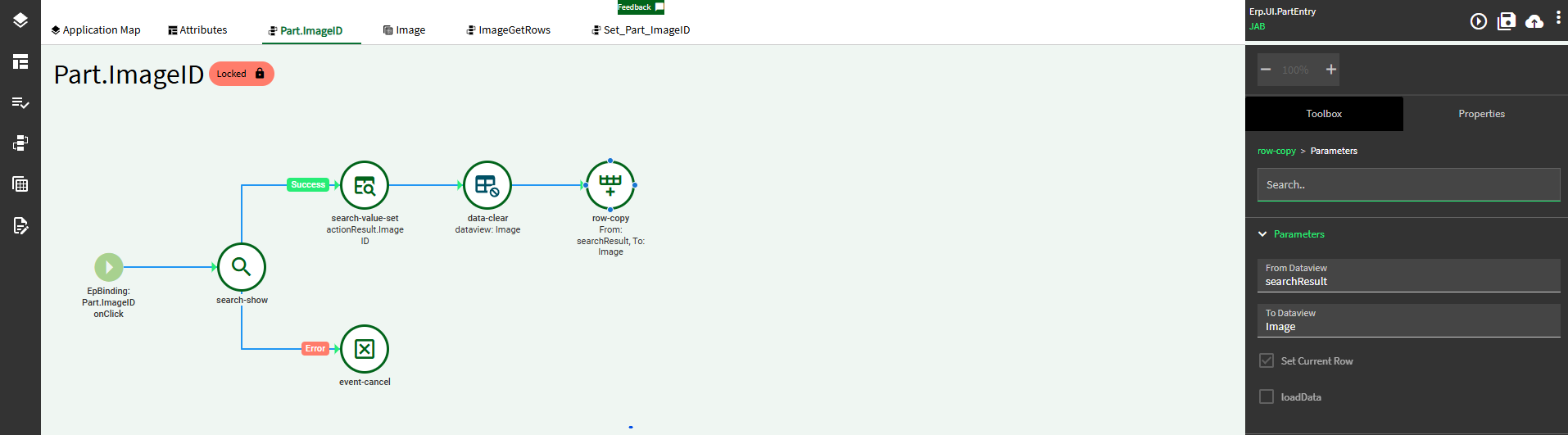

You may need to tweek your onSearch events as well. ParEntry appears to copy the searchResult row to the Image row.
Hmmm ok interesting. So the wizard created BO_Image_GetByID and BO_Image_GetNewImage as events. So I supposed I then need to use the BO_Image_GetByID and change the event to DataTable, Column Changed and mark the image? When I wire that up and select an image which populates the Logo_c column an error pops with Record not found.

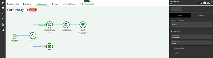

I did see Set_Part_ImageID what I’m not understanding is when is that triggered? There’s no trigger set on it, so that runs every time? Also it’s calling Image.GetRows does that trigger the Image dataview which only grabs ImageIDs associated with my view?

Like I said, I believe PartEntry may do this in onsearch event by copying the searchResult dataview to Image dataview. So the Image data may be populated automatically from search. I’m unclear what populates the image row initially when the imageid is already set on the part. It could be that search-value-set runs everytime. I beleive onchanged execs everytime as well. Let’s look into that technique if onchanged doesn’t do the trick for you.
