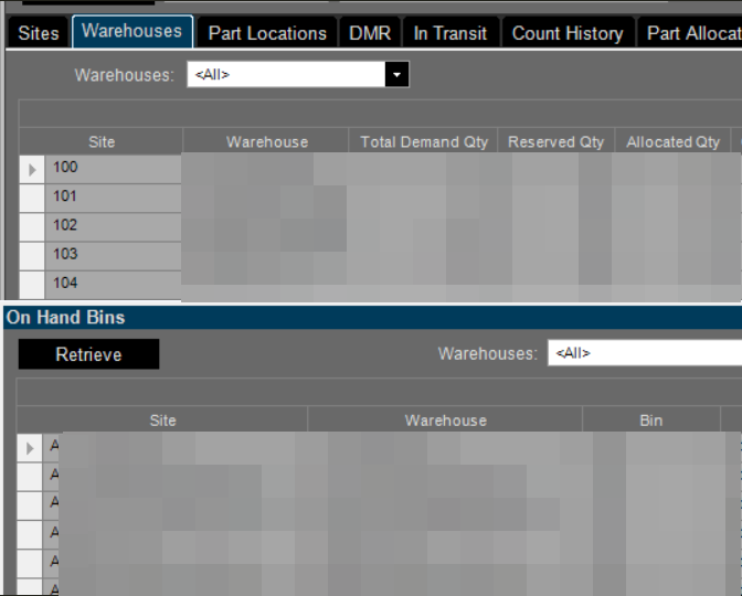

Site columns displaying different values in different tabs
Why would the Site column in the Warehouse tab and the Site column in the On Hand bins tab not both show the same value? I would like to see the numerical value for the Site in both tabs.
Looks like one of them is using the Plant.Plant (Site ID) and one is showing the Plant.Name (Site Name). Might have to do a customization to change that.
Only alternative to doing a customization (that I can think of) would be to change the Site Names to match the Site IDs. I would definitely look into what else that might affect (reporting, other deparments, print forms) before doing that, though.
To answer the why
Two different developers worked on the different forms
One linked the plant table to the query the other didn’t
Epicor is not consistent across the entire database
Some say that 500 plus developers worked on the uplift from E9 to E10… Not sure if that urban myth is true or not, but we do know that there were multiple teams and they were based in different LOTE countries, which may have contributed to some of these inconsistencies.
I am not going to touch Q.A. There I said it :slight_smile:
Fair to say, it was Huuuuge effort to move a piece of software from one stack to an new one.
