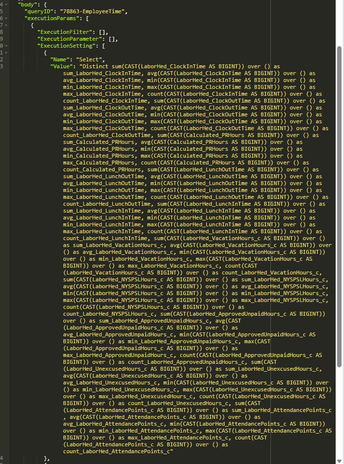

So I never really looked at this, but apparently the summations work by modifying your BAQ and running it??? It seems like first it sums based on data loaded into the client and then it runs a modified version of the BAQ to calculate and override this first value? So its overriding my BAQ select statement with this automatically generated garbage that is casting my decimal fields to BIGINTs

Thanks for the response @Olga , appreciate your honesty. Besides the video and trace, do you have any recommended verbiage for my support case?
If it is only rounding problem then I guess it is easy to fix with just reporting it.
If your field is decimal, there is no explanation why SUM should become integer. Just add this screenshot.
Technically its changing the case on my name as well, but I don’t care about that as much. Less likely to cause a real business error.
What could possibly go wrong, executing arbitrary SQL sent from a browser session.
BAQ already transferred the full results before the grouping request. Javascript’s native .groupby() will always outperform reimposing any entire query load and transfer.
Decimal → any integer type does not round, it truncates. The development team has vigorously disagreed with this, but it’s really important to continue insisting to them that verifiable core principles are true, because this particular misunderstanding applied in a domain that handles currency causes measurable harm.
