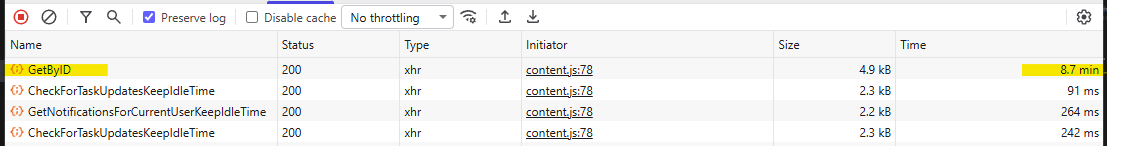

EDIT: eventually I got this:

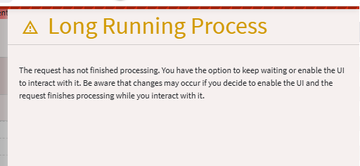

After clicking Wait on the Long Running Process message, eventually it responded. :roll_eyes:

Spoke too soon… Appears transient. May be related to opening the solution having tracking enabled. Problem solution had tracking eneabled, moved tracking to another solution. First solution is normal and other solution now slow. Request pending 4.5min to get a 4.2kb response.

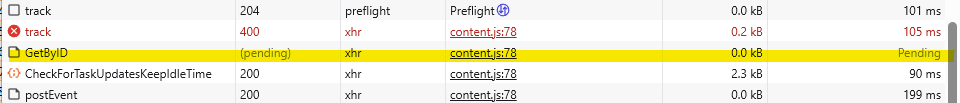

It’s definately the tracker solution that’s slow. I’m importing solutions after a refresh and switching tracked solutions to keep them like so:
Everytime I open the tracked solution, the request is pending for several minutes.

I have a case for a different part of this same issue. I reported that the Long Running Process slide breaks the import slide. Reported as a UX issue, but support expressed an inability to repro getting the slide to come out. I can repro that with context of tracking as well.
