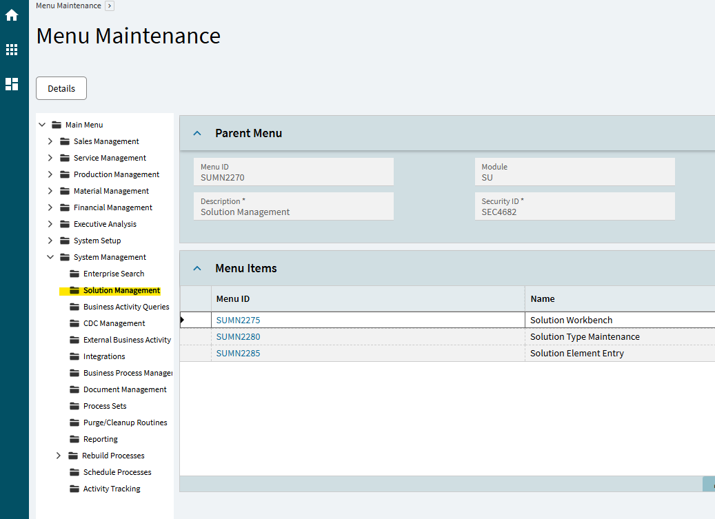

It’s still there on the menu where it should be, and adding a menu item for it manually still gets filtered out. So, it seems a purposeful change. I wonder why?
The only mention in release notes since 2025.2.7 for SWB is this: 2025.2.10: Solution Workbench only import layer to current company instead of all companies

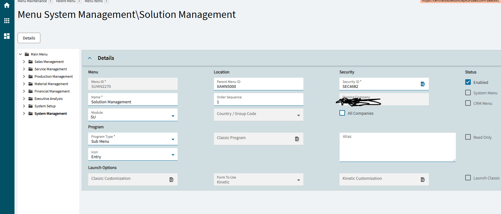

Looks like this SubMenu Item SUMN2270 is missing
I tried to add it back in my own menu item and got nothing, does it work if you try and put it back?
yeah its the parent submenu item of solution workbench thats missing. I added the sub-menu item with the same menuid and the solbench items were all there beneath.
Hooray, it works! Why did they go and do that?! whee.
