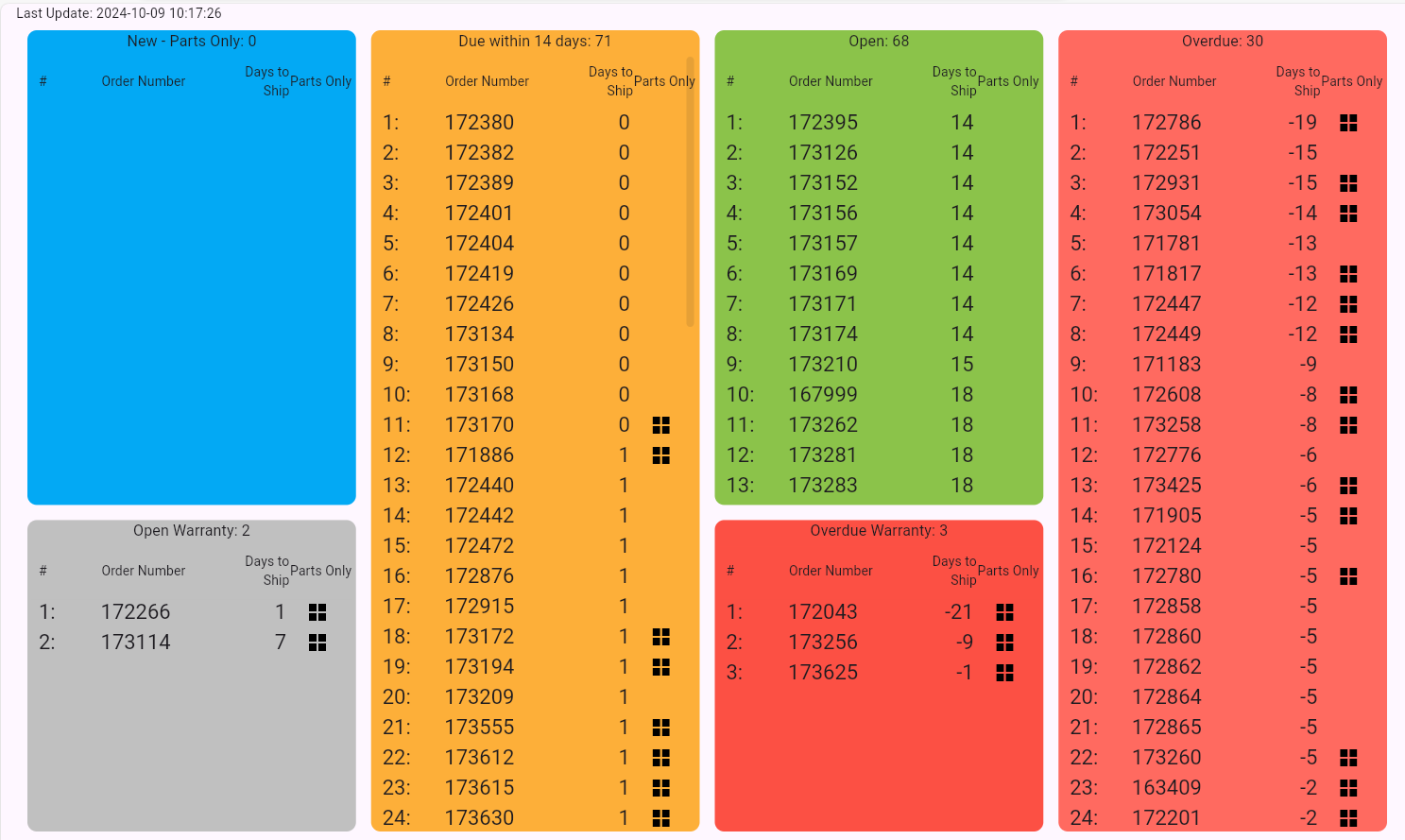

I’ve created a Data Directive against a UD table that when an Order number is added to the UD table, the order’s pick list is Autoprinted. To accompany a web app dashboard for our shipping department:

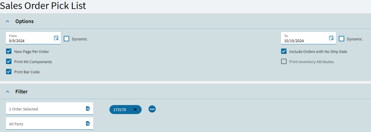

If I go into the SOPick report and run the report manually (entering the dates and order number into the form), the report generates correctly.

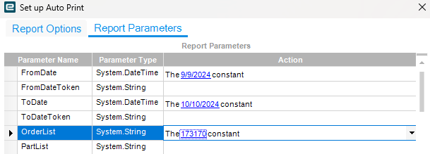

Here is my report parameters screen
I assume that I must be entering the OrderList in an incorrect format. But everything else I’ve tried gives me an error on the server of “The input string ‘[173170]’ was not in a correct format.”

Did you try putting 173170 in double quotes?
  • Constant: “173170” gives me a compilation error
  • Constant: \“173170\” gives me “The input string ‘“173170”’ was not in a correct format.”
  • Constant: ‘173170’ gives a compilation error
Can you specify an expression there? Maybe try to use a convert(nvarchar, 173170) or something to that effect.
rather than a constant 173170
I tried
Expression: 173170.ToString() - No records selected
Expression: “173170” - No records selected
Could someone else try this? Set up an autoprint for the SOPick report for a single Order? can you get it to work?
did you try creating an array and putting a single order in the array? If it’s expecting a list, it may be looking for an array object instead of a text or number.
[‘173060’] was not in a correct format.
["173060"] fails quietly
Try putting a ~ after the number all encased in double quotes
"173172~" fails silently
173172~ gives the error : The input string ‘’ was not in a correct format. Which is odd because it thinks the string constant is empty.
