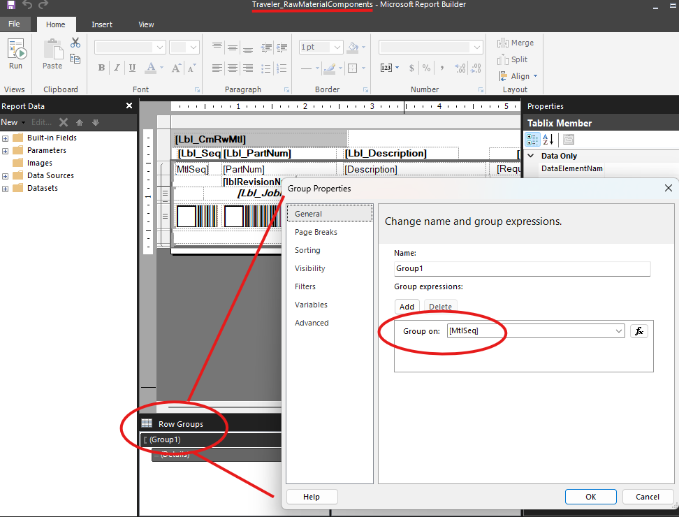

In the top level report is a reference to the subreport: Traveler_RawMaterialCompoents.
When I look into that subreport I can find a reference to how the repeating Material Lines are grouped on the Material Seq.
If I had to try to modify what you are asking, this is where I’d start:
I think that you have a start point of the Row Groups focusing on the Material Sequence (MtlSeq) in this portion and I assume you’d need to start your modification there.
But there is a lot of work and testing to see if the truly is the spot you need to start editing in a copy of this group of reports.

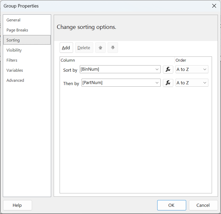

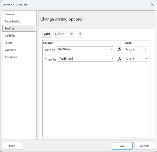

We use the job picklist grouped on AssemblySeq and then sort by BinNum
