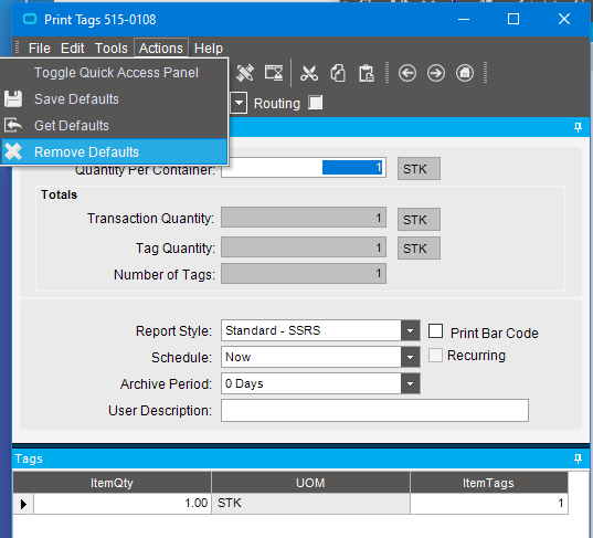

I did attempt to set defaults to base, and purged all personalizations. Issue persisted sadly. I’m off for the rest of the day, so I will pick up again tomorrow. Thank you.
Does the report run okay for the base Report Style? wondering if this is a long lingering/dormant issue. Could you post a screenshot of the rdd with the tables/relationships? as well as the SSRS SQL Query?
@LoganS Actions > ‘Remove Defaults’ is not the same as Tools > 'Reset Layouts To Base’
Actions > ‘Remove Defaults’ is DATA defaults.
Tools > ‘Reset Layouts To Base’ is the UI Layouts.
