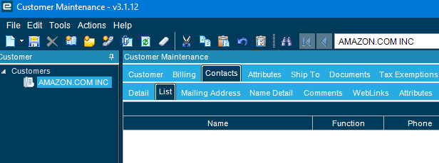

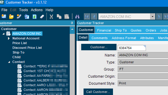

Thanks, Jose. That worked to stop the load in Customer Maintenance, but it still loads in Customer Tracker. Yet the trace doesn’t show any different BO being loaded. EpiMagic?

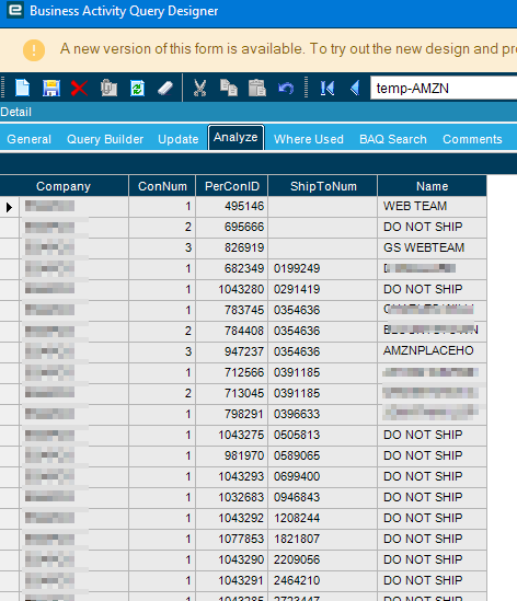

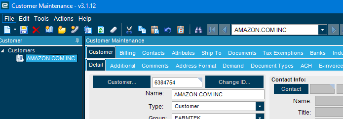

And something seems corrupt - They don’t even show up in Customer Entry (other than the first three w/o a ShipTo). Looking at the CustCnt table filtered for the CustNum, many share the same ConNum. Normal? Or something wrong?
Yes as the Customer Contact is tied to both the CustNum & ShipToNum. If you look at your screen shot you’ll see the duplicate PerConID’s have unique ShipToNums.
Thanks, Randy. Good point! I missed that, since DMT only required Company, CustNumCustID, and ConNum. At least it’s one less thing to worry about.
