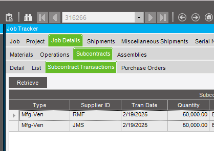

As of 10.2.700.40 there is no issue with this. I’m not sure if this might have changed in a more recent release, though.
One subcontract Op for a total of 100,000 EA. I was able to create two POs to two different vendors and created two subcontract shipments to the two vendors - one to each for 50,000 EA.
Epicor even automatically picked the correct PO # for each when I entered the job information in subcontract shipment entry.

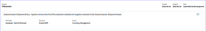

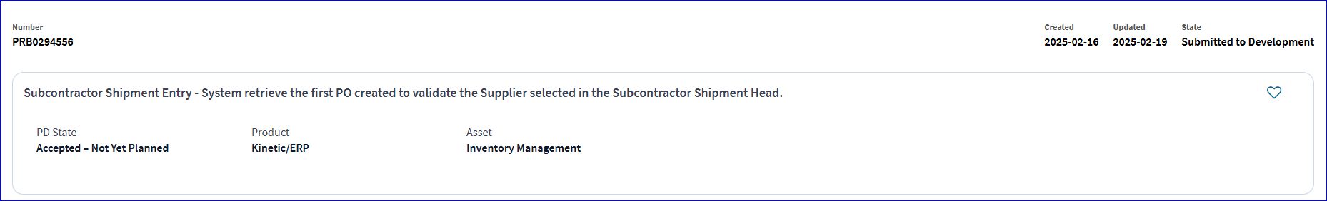

Well… wouldn’t you know it… I went onto EpiCare to see if it was a reported problem and:
PRB0294556 just entered a few days ago.
Able to duplicate in current code 12.0.100 and 11.3.200
Unable to duplicate in last release 11.3.100.23
[so, apparently this is a new bug]
Problem Description:
Subcontractor Shipment Entry - System retrieve the first PO created to validate the Supplier selected in the Subcontractor Shipment Head.
Expected Behavior:
System should not retrieve the first PO created to validate the Supplier ID once the operation sequence selected in Subcontract Shipment line. Should allow user to select the PO needed when multi supplier created for a Subcontract PO.
Additional Information:
Same Issue for both Classic and Kinetic UI.
