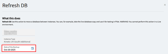

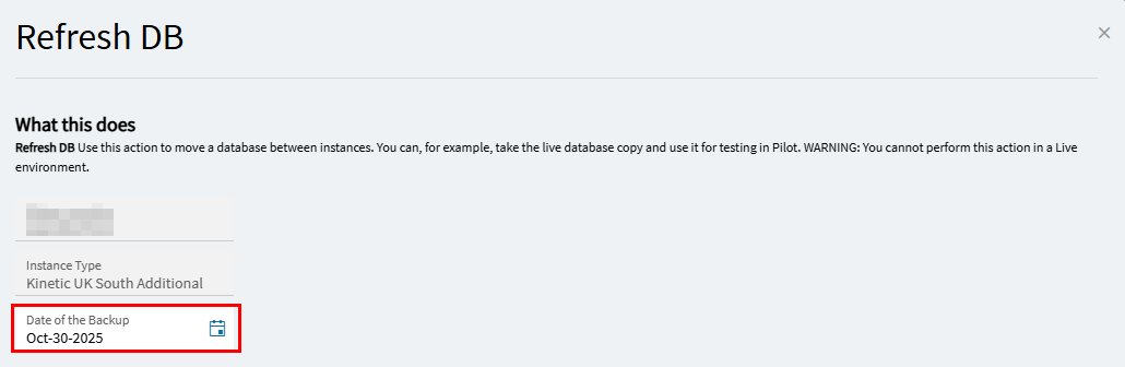

Add Timestamps to CMP Refresh DB Backup
On the Cloud Management Portal, there is a lack of timestamp visibility onthe backups, making it difficult to confidently choose the most accurate restore point.
For example on the 31st, I selected the 30th do a DB restore.
Only afterwards to find all the customisations loaded into the DB on the 30th were missing..spooky :ghost:
It was later found when I reviewed the logs that despite the 30th being selected, the 29th differential backup was taken.
If the DB backups had timestamps, I could have seen there was no backup taken on the 30th!
