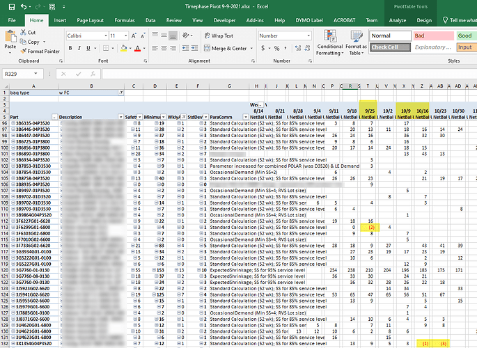

We tie together PartDtl with filters on SourceFile (i.e., Indicates the record type that created this record.
JH-JobHead, JA-JobAsmbl, JM-JobMtl, JO-JobOper, PO-PoRels, OR-OrderRels, FC-ForCast ) along with PartBin and take it out to Excel, about weekly, to review where we will have shortages. I think you should be able to use same query to get at your data/report.
Have you looked into using PartDtl for summing demand and supply, along with Partbin for summing QOH, to get at the data?
Hey Chance, I’m just looking to get the output of “N number of X Part” per day in the final rows there as an analysis tool, doesn’t need to have a lot of drill down. Perhaps that’s the right way though, export the data and manipulate in Power BI?

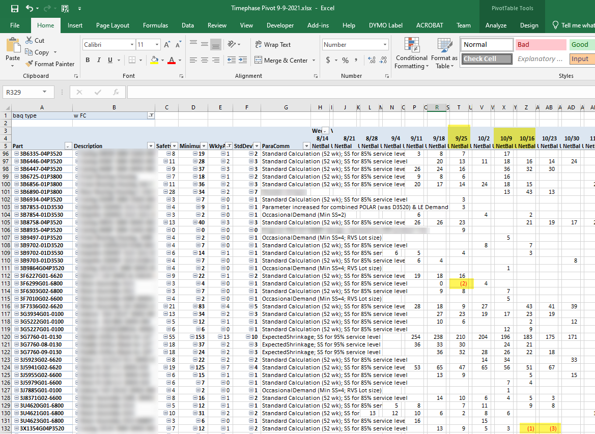

Hey Nancy,
I admire the complexity of your solution. This is actually UD table data so I bet my solution will actually be somewhat less complex, but seeing your document is very similar to the end result I’m going for
Looks like you’ll need two grids for your results. First containing a query with the partlot table and a bunch of calculated fields for how many days you could need visibility out for (Im assuming you wont need something crazy beyond 30 otherwise this isn’t realistic). Second grid would just be an identical query that is wrapped with a parent subquery to group by Company and Part. The parent subquery will help you easily count across lots.
