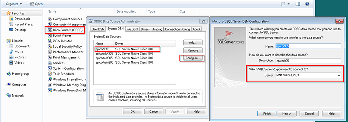

You can open ODBC and review the data source
Where do you begin to look where the ODBC is located to review the data source?
Go to the Control Panel – Administrative Tools applet on the Application Server or use search to find it. The Application Server that the environment points to is in the lower right portion of the client screen.
64bit ODBC Data Source Administrator:
Start > Run > c:\windows\system32\odbcad32.exe
32bit ODBC Data Source Administrator:
Start > Run > c:\windows\syswow64\odbcad32.exe

Found the server and the ODBC connection. It turns out it was the correct sql server but wrong instance. Thanks for the help.
