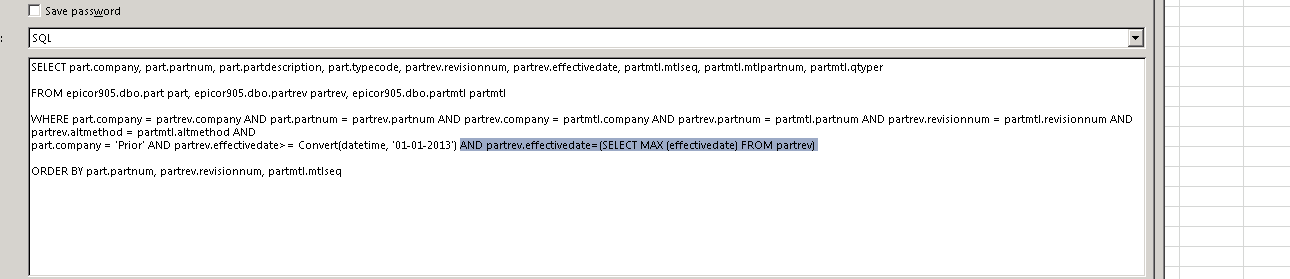

I’m creating a table of data in excel with the below SQL script…what i’m trying to do is only return the data with the latest Partrev.Effectivedate
Im trying to do this with the highlighted part on the screenshot using SELECT MAX but its not playing!
Are there any sql experts that can help me pull this together? Many thanks.

Maybe you can paste the query so we can manipulate it. One thing I’m noticing is that your select MAX() has no criteria/join… So your query is looking for the MAX(effectivedate) of the entire table. something along the lines of = (SELECT MAX(b.effectivedate) from PartRev b where b.PartNum = Partrev.partnum and b.Partrev.revisionnum = partrev.revisionnum)

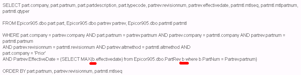

SELECT part.company, part.partnum, part.partdescription, part.typecode, partrev.revisionnum, partrev.effectivedate, partmtl.mtlseq, partmtl.mtlpartnum, partmtl.qtyper
FROM epicor905.dbo.part part, epicor905.dbo.partrev partrev, epicor905.dbo.partmtl partmtl
WHERE part.company = partrev.company AND part.partnum = partrev.partnum AND partrev.company = partmtl.company AND partrev.partnum = partmtl.partnum AND partrev.revisionnum = partmtl.revisionnum AND partrev.altmethod = partmtl.altmethod AND
part.company = ‘Prior’
ORDER BY part.partnum, partrev.revisionnum, partmtl.mtlseq
give this a shot?
FROM Epicor905.dbo.part part, Epicor905.dbo.partrev partrev, Epicor905.dbo.partmtl partmtl
AND Partrev.EffectiveDate = (SELECT MAX(b.effectivedate) from Epicor905.dbo.PartRev b where b.PartNum = Partrev.partnum and b.revisionnum = partrev.revisionnum)

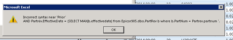

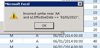

Hi Dan, It returned an error unfortunately.
Hi Josh, it returned an error unfortunately
look at the quotes. its not copying right from the website
most bizarre…it copies how you’ve wrote it perfectly, but the error shows " instead of just working or showing a ’
but its still returns the same error
Either way you should replace them. delete and re-write the '.
You need to update to your company name.
Looks like it is not processing the quotes properly. Was hoping you would use the code as an example and rewrite into your editor. Looks like you are using Epicor 905 in a BAQ designer and not SQL server directly so syntax will probably need to change.

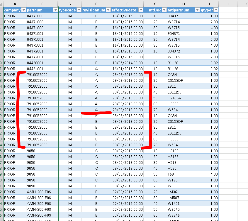

Analysing the results, its certainly done something…as its reduced the total number of rows returned, but on the odd occassion i can’t understand why for eg. on part number 7910052000 it has returned revision A and B?..The latest revision date is revision B so i’d have hoped that should be the only one showing for that part number.
I see what you are trying to do now. It’s returning the MAX date of a given part/REV, not part. Try removing the b.revisionnum = partrev.revisionnum portion.
Edit: This may not guarantee a single rev if two revs have an effective date of the same date.
It looks to have worked a charm, i’ll just test the data some more to confirm.
Thank you for your help.
Also,…if 2 revisions do have the same effective date, it’d be fine to return both revisions
It seems to have done the trick. Thank you so much for your help.

If you look, the table itself is named b… its just an alias for that table since there is a parent table named PartRev. So with your “(select max” is a whole new sub query. If we didn’t name it b it wouldn’t know which table you are referencing. Technically you could rename it to what ever you wanted.
