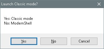

A powershell script that displays a dialog with two buttons?
Each button runs a different command line (the target from each of your two icons)
Add-Type -AssemblyName PresentationFramework
$wrkdir = "C:\Epicor\ERP10.2Client_UAT\Client\"
$prog = "C:\Epicor\ERP10.2Client_UAT\Client\Epicor.exe"
$args = " /config=UAT_102300.sysconfig"
$args_classic = " /classic /config=UAT_102300.sysconfig"
$msg = "Yes: Classic mode
No: ModernShell"
## the above need to span two lines if you want the line break
$msgBoxInput = [System.Windows.MessageBox]::Show($msg,"Launch Classic mode?",'YesNoCancel')
switch($msgBoxInput){
    'Yes'{
        ## Launch Classic mode
        Start-Process -FilePath $prog -ArgumentList $args_classic -WorkingDirectory $wrkdir
    'No'{
        ## Launch Modern mode
        Start-Process -FilePath $prog -ArgumentList $args -WorkingDirectory $wrkdir
    'Cancel'{
        ## Don't launch either
Yields:
edit
Make a shortcut to the PS1 file, and then change the shortcut’s target:
C:\Windows\System32\WindowsPowerShell\v1.0\powershell.exe -ExecutionPolicy Bypass -File "C:\Users\ckrusen\Temp\E10_Mode_Select.ps1"
The part after -File is what the shortcut’s original target was.
Edit #2
Add -windowstyle hidden to the shortcut target to suppress the Powershell Window that pops up while the script runs.
Add parameters 'Question', 'No' to the MessageBox call, to show the question image, and set the default button (the one that fires when you hit enter key) to the No button.
...Show($msg,"Launch Classic mode?",'YesNoCancel', 'Question', 'No')
for a slightly nicer Prompt that defaults to Modern Shell.
