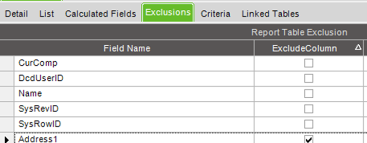

    a. Added UserFile as a data source
    b. Unexcluded the necessary fields:

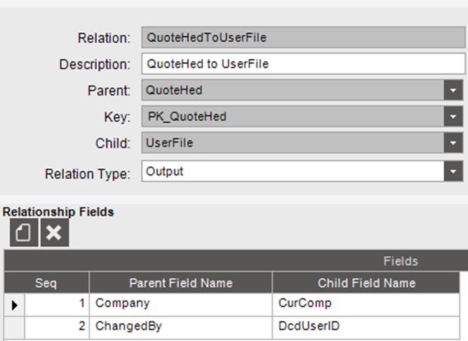

c. Created the relationship between QuoteHed and UserFile

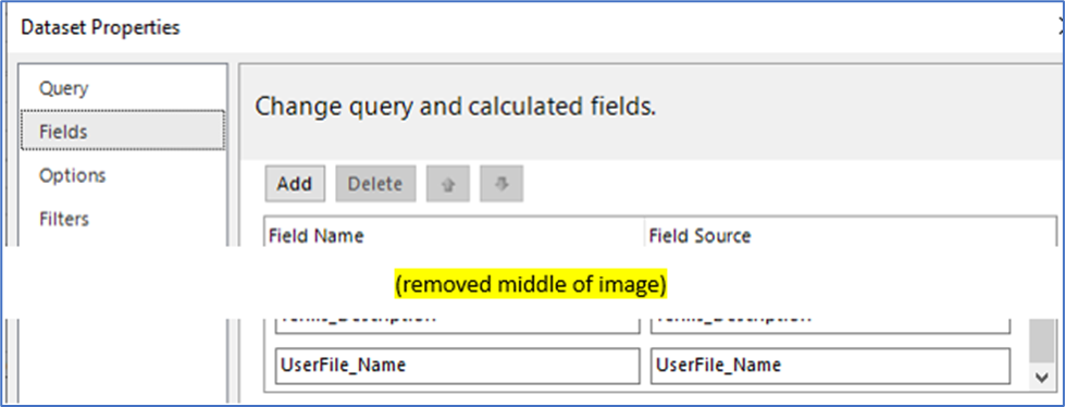

  1. In the RDL Quote Dataset Properties,
    a. Added UserFile_Name to the Field List:

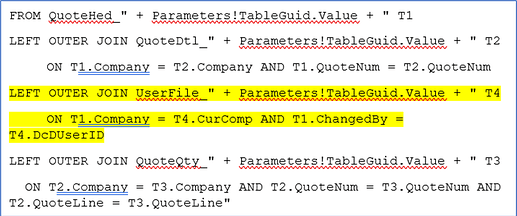

b. Added the table to the query FROM statement:
c. Added the field to the query SELECT statement:

Change your ā€˜Field Sourceā€™ from ā€˜UserFile_Nameā€™ to ā€˜Nameā€™

As Brandon pointed out, your field source is wrong. In the query youā€™re just calling it ā€œNameā€ from the T4 table, then in the Fields list youā€™re asking it to pull a column called ā€œUserFile_Nameā€ which doesnā€™t exist.
I would also change the join - company is almost always required to ensure that you pull the correct data, and even in single company to ensure you hit the sql index for performance reasons. In this case you donā€™t want to link to CurComp, if it is/was multi company you would only get a name back some of the time depending which company the user is working in. So just join on ChnagedBy and DcdUserID.

Thanks so much, both of you. Changing to ā€œNameā€ in all three places (query, data source and expression) put the actual name on the base Quote form.
We have only one company, so I did not change the join on CurComp.
