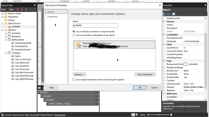

We had the same issue and found the instance for the upgraded Epicor had a different name. So I had to go into each report and subreport to change the name of the Epicor Instance.
Thanks @Vinaykamboj! Where exactly are you changing the instance? I looked at the new RDL I created and a converted one and the datasources are identical.
I use Report Builder for SSRS reports. So I went to properties of the Data source and selected the SharedReportDataSource again manually with the new AppServer and Instance by browsing for it.
Ah, you mean the report server!

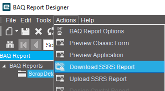

Download the RDL
Open the RDL in Report Builder
Change the Report Server location

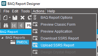

Upload the RDL

Also, downloading works for my cloud friends!
