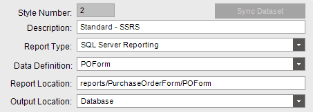

So i have a SS Breaking Routing Rule on the PO form. I had copied the report style and created the routing (this was on premise). We upgraded to Public cloud and i am trying to modify the routing but i get the error that i need to be a global admin. I believe this is bc its a system report. What do i need to do to re create the PO form so i can modify/create a routing to email the Po form? I copied the RDD but not sure regarding the report in report style. Any help will be appreciated.

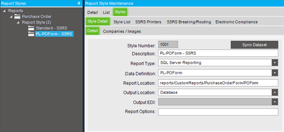

I copied the report style to see if that was the case but the create breaking/routing option is still grey out. The only time the option is not greyed out is on BAQ reports.
Once a Break Routing is applied to a style, some of the style’s fields become read only. Particularly the Data Definition (RDD).
I always suggest making a copy of the RDD, then specifying the Copy of the RDD in the new Style to have the B/R. You won’t be able to change the selected RDD for the style. But if it’s referencing a copy of a system RDD, you’ll be able to update the copy of the RDD (system RDD’s cannot be edited).
Also, I think the table to break on, becomes Read Only once you start designing the B/R.
