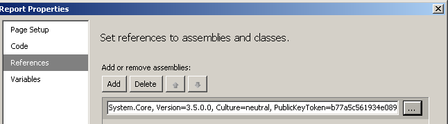

Trying to upload SSRS report thru Epicor , Report style but I get the following error when doing so. Please help. Also I had to add a reference to System.Core

In additional , I don’t even call any function inside the report, just by having that line of code it breaks.
