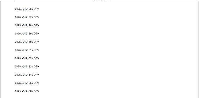

I am trying to create a “detail” data section in my report where I will display all the “SerialNumbers”.
Each field is about 20 chars so I would like to print them across and then down to display as many as possible on the page. I’m still and infant when it comes to SSRS Report designer, but I’m eager to learn. I’m sure the answer is pretty simple, but I have been trying things and looking for a whole day.
Example 1):

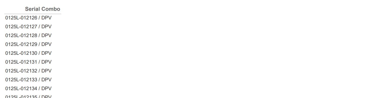

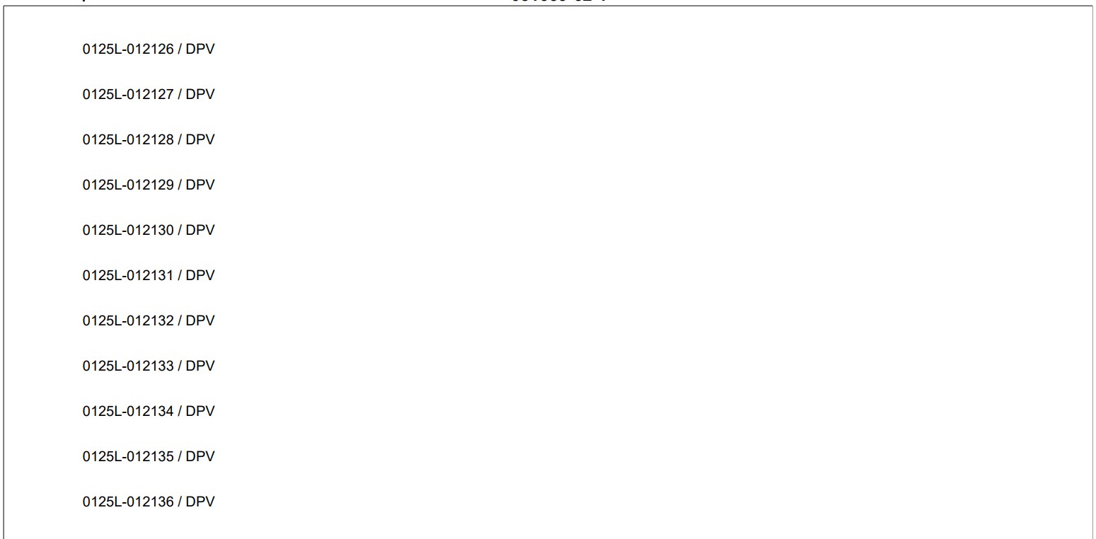

I inserted a “list” and put in my re-occurring data…
It works create, but just displays down…
example 1a

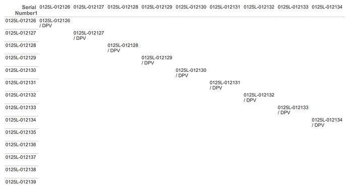

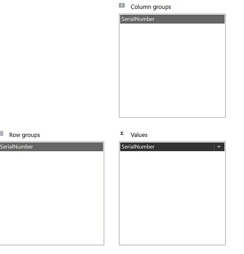

Example 2):

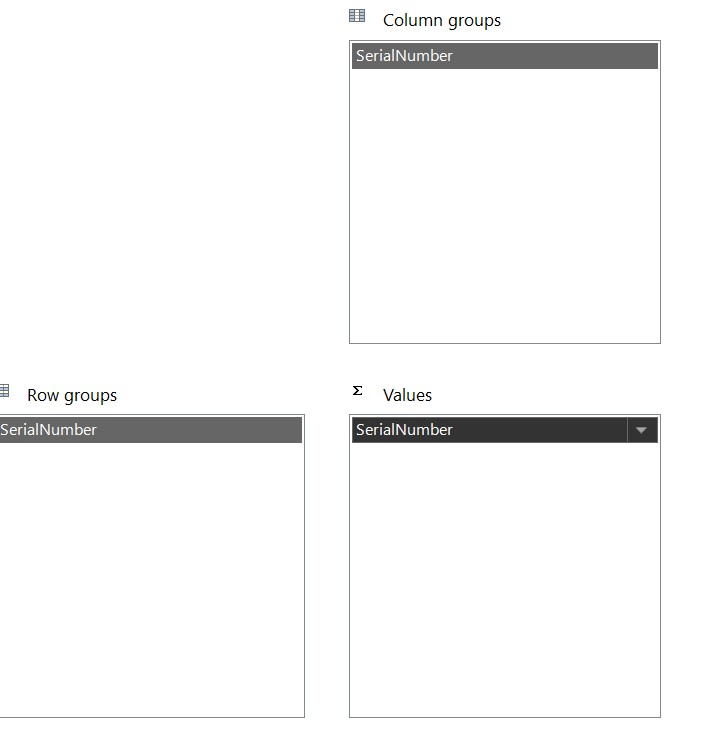

I used the table wizard to create a table… I put in rows and column groups…
e.g.

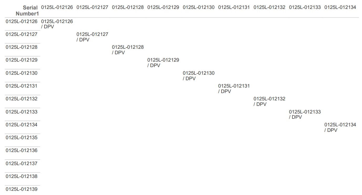

The output makes me Laugh…
I just want the data across and then down.

It would help maybe if you put what you want the desired out put to be in EXCEL.
Get rid of “SerialNumber” in the Columnn Group.
I have done this using a table - Google “SSRS Multiple Column Report” I would show the example except I have become feeble and do not remember if I had Breakfast. :slight_smile:
It can be done with 2, 3, 4 columns - whatever you like.
DaveO

Yes, that gives me the same output as “list”:

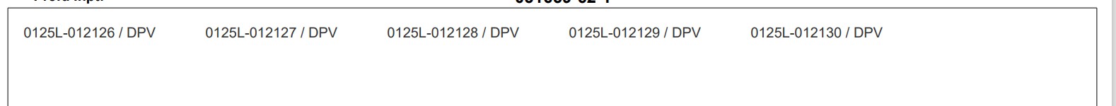

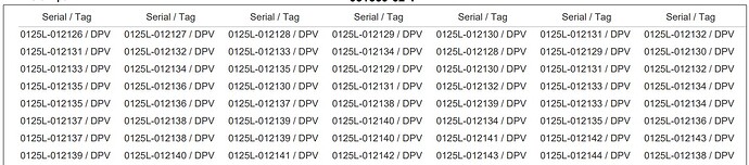

The closest I’ve come is putting the field in the “column”…
This works perfect, but it puts a page break..then continues with the “detail” data on the next page
So this works for across, but now I need down…

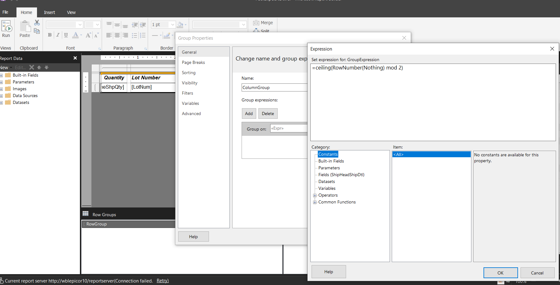

I found it - this is being used to show lot numbers for a pack slip. But the logic is the same.
Sorry I forgot you need the Column Group as a formula as well.
DaveO THANKS!!! You gave me the information that I needed to do this.
-LaMont…
Still tweaking the ceiling calculations between the Row / Column group expresions…,but I’m getting real close,
-LaMont…

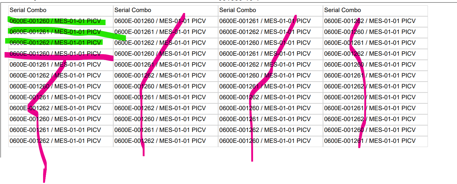

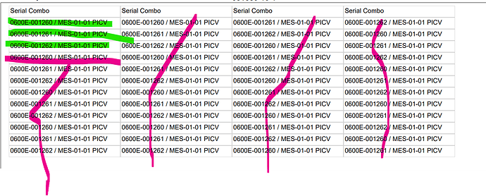

DaveO your “group” commands worked really well for the “formatting”, but for some reason that I don’t understand the data is repeating and duplicating.. e.g. (There are only 3 occurrences):
I’m sure there is something simple that I am missing… Thanks if you happen to know why this is happening…

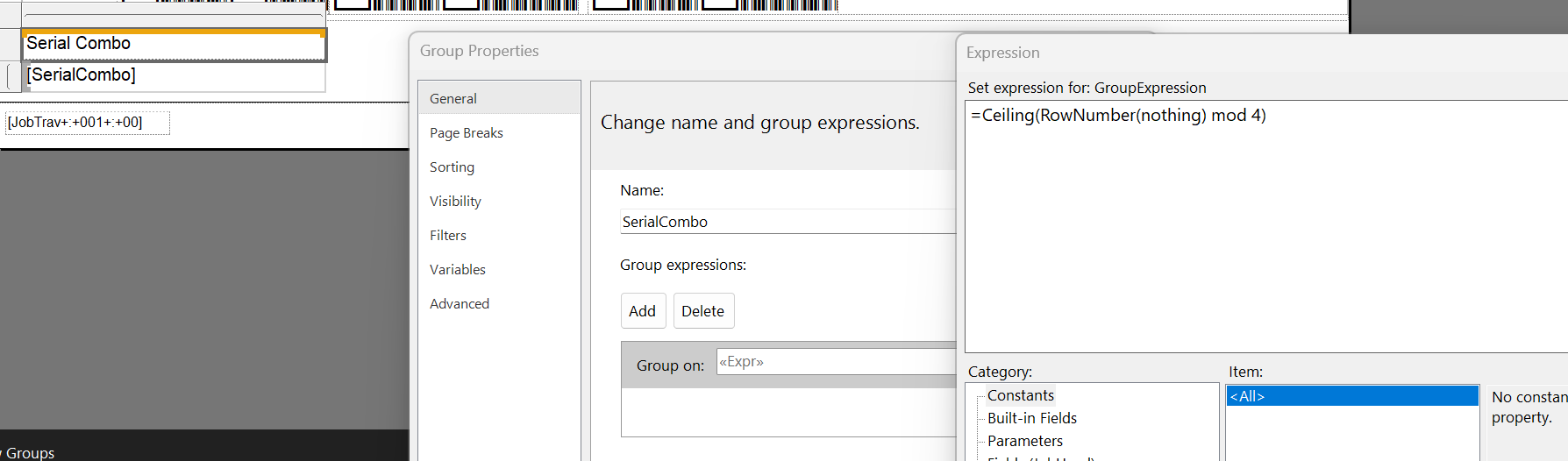

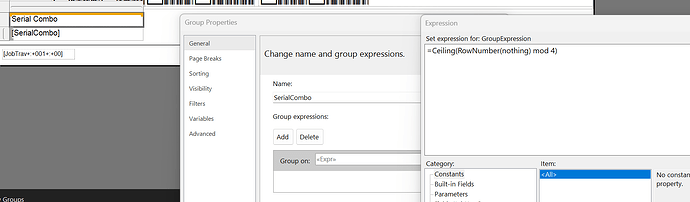

Here are my formulas: (column)

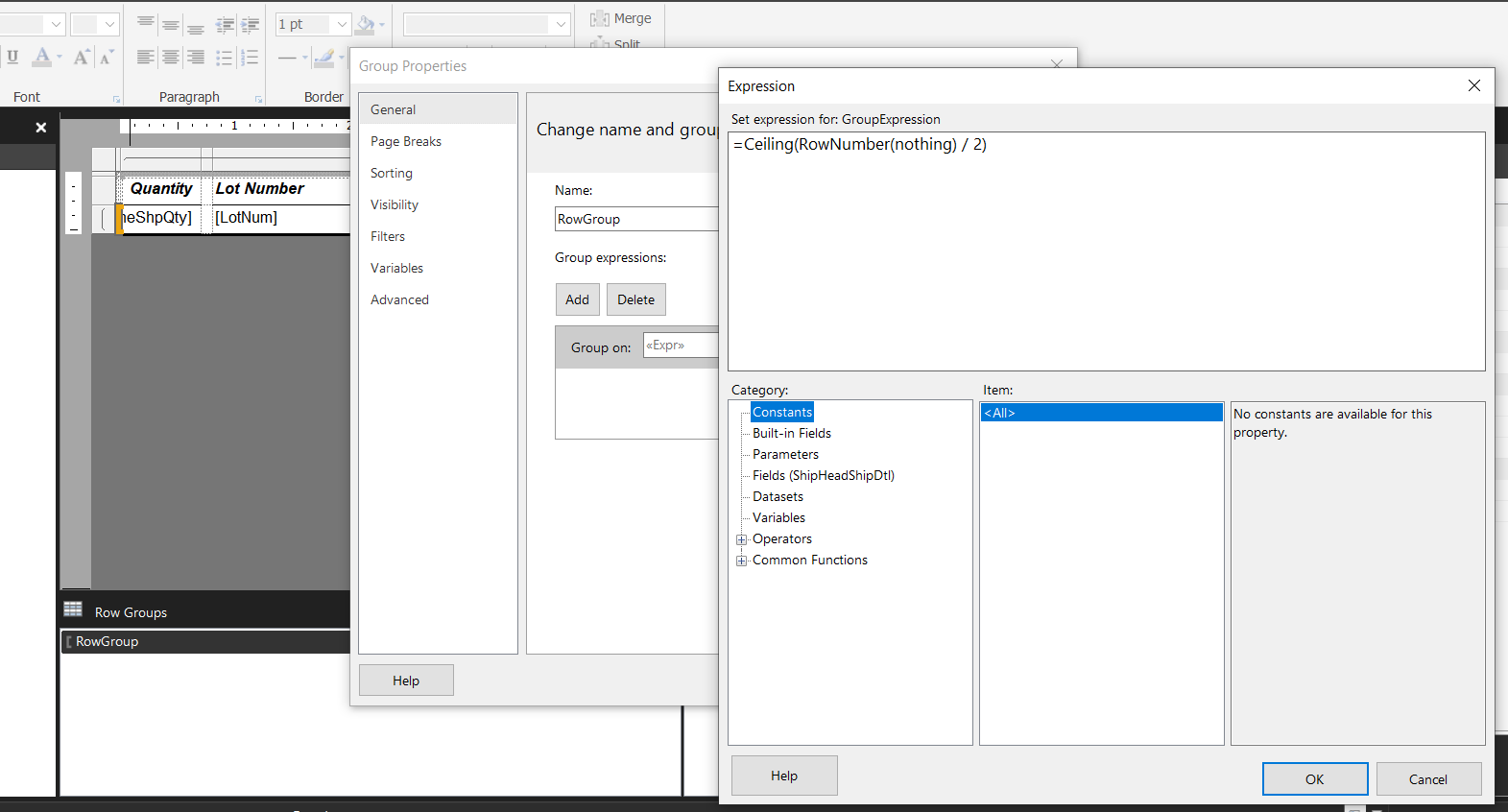

Row formula:
Really appreciate any ideas I can try…
-LaMont…
I’m just spit balling - have you tried adding a group for SerialCombo? Show the Group Header line and suppress the Detail lines?
DaveO
I found a way to get rid of the extra lines with some “visibility” expressions… I think your suggestion to create a sub report is probably a good solution…which would probably avoid what I was seeing here… I’ll resolve this thread… Thanks ALL again for your help. -LaMont…
