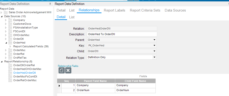

What did you change in your custom style/RDD?
You’re showing the relationship between OrderHed and OrderDtl… but that’s a standard relationship in the base RDD.
Can you post your custom RDL query?

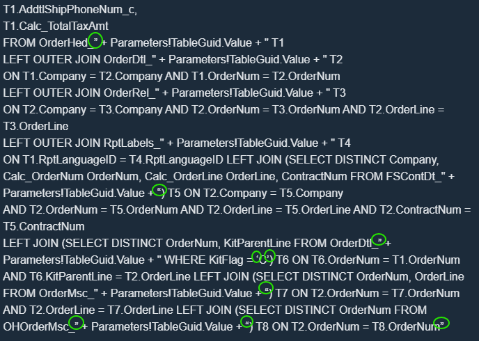

Well, its tough to tell what could be an issue, and what could be an artifact of copy/pasting into the forum.
But first thing that jumps out is the mix of straight and curly quotes, apostrophes.
Are these all “straight” your RDL?

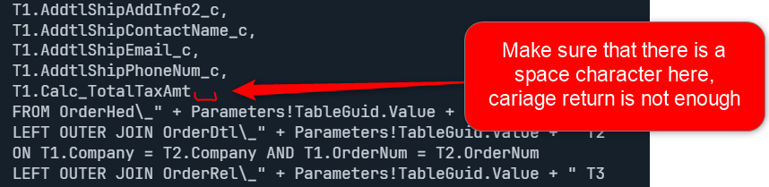

When adding new stuff to the select statement, I always forget about adding a space character at the end of the line. Welcome to SSRS
