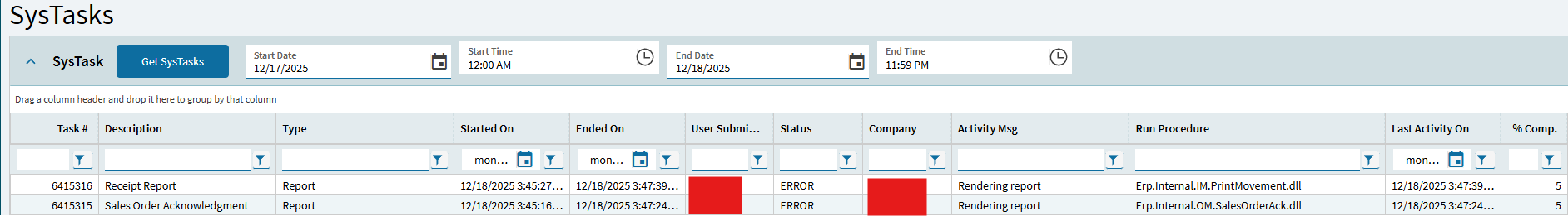

I have a detailed accounting of every various error message we’ve received from this SSRS failure in my case, CS0005076035, there is literally so much there it lags the web browser now :open_mouth:
Error output varies, but it looks like a concurrency error on client/server code between AppServer and SSRS server, when it gets to “copy the rdls from .zip in CustomReportStore to SSRS server” - and multiple reports are running same instant - tries to overwrite .rdl file on ssrs server while open for reading, etc. fails. needs to have a queue or similar implemented when same report style (files) are printed on epicor side so ssrs server can be thread safe. because report style 1 can share files with report style 2, can share files with report style 3. middleware code will not queue these up and execute simultaneously. so not adequate to queue up report styles - code needs to be aware of .rdl files and queue up differing styles with overlapping rdl files.
I’ve been working with Epicor for months on this issue, at least they added multi-level inner exception output to the error messaging now, which is helpful.
One sample error below (note there are about 9 possible errors but all seem related to thread safety)
Entry #: 1, IsError?: TRUE, MsgType: ServerError
2025-12-18 03:47:39 PM
MsgText: Program Ice.Services.Lib.RunTask when executing task 6415316 raised an unexpected exception with the following message: RunTask:

So the most detailed error is in system monitor, and in your case I see this error almost always:
The item ‘/SaaS_XXX/reports/ProductionDetailReport/ProdDtl’ cannot be found. —> Microsoft.ReportingServices.Diagnostics.Utilities.ItemNotFoundException: The item ‘/SaaS_XXX/reports/ProductionDetailReport/ProdDtl’ cannot be found.
What is in System Monitor task error?
The error I pasted above was copied directly from the system monitor. Here is where I copied that detail from:
That one is probably my 2nd most common error, “cannot be found”
This one is my most common one:
