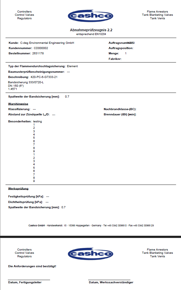

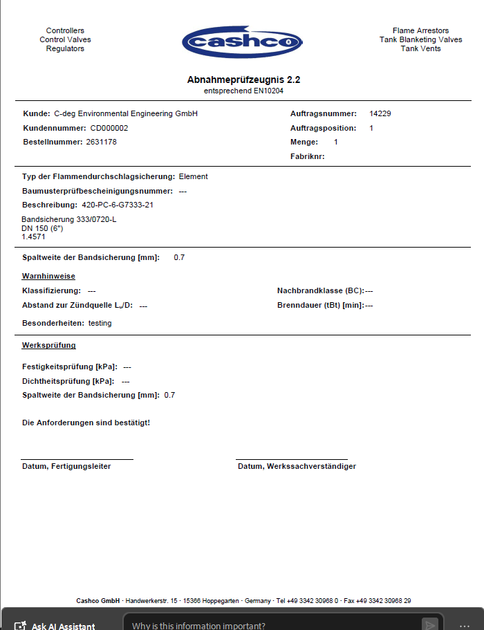

I have a report that works fine as long as it’s single page, but as soon as it goes to two pages, a couple fields start overlapping their labels. I’d be happy to provide further details, but I’m not sure what would be relevant.
Report builder:image
Single page:image
Two pages:image
Total guess here… but could it be a “White Space” issue? Do you have that setting enabled to trim white space on the report settings? If so, maybe try disabling it.
I appreciate the guess, but that’s already False for me.
Is it that the content above it pushed this to a second page or like the report prints multiple pages with the same data and subsequent pages format unexpectedly?
Could you send full screen shots of the executed report, both the 1 page and 2 page version?
These fields are right below the header on the first page. The content below is what causes the multiple pages potentially.
