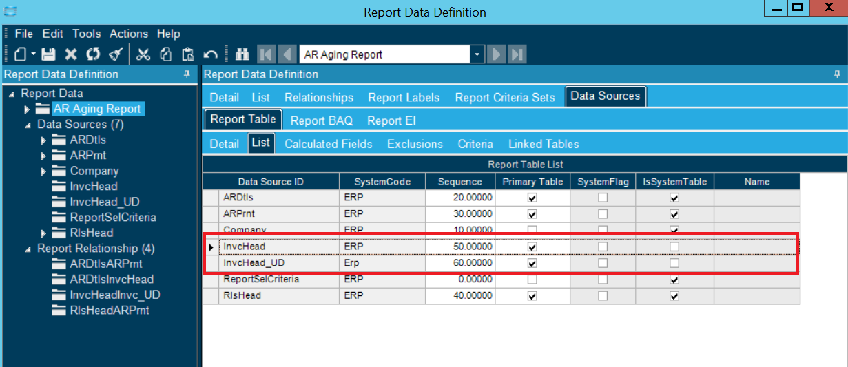

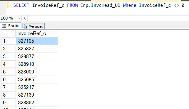

Dear Experts, We have added the custom UD field (InvoiceRef_c) in InvcHead table. How to add this custom field in AR Aging Report.
InvcHead

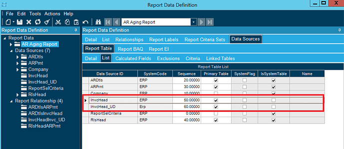

I have added the two tables in report data definition
  1. InvcHead 2. InvcHead_UD
Created the relationship between them. After this created the new relationship between InvcHead and ARDtls tables.

You don’t need to add InvcHead_UD in the Report Data Definition. Your custom field should be available in the Exclusions tab under the regular InvcHead table – Epicor will reference the view that includes the UD columns. Make sure the field is not excluded and then add it to the RDL query.
Perfect - Tyler. Your assistance is appreciated.
Thank you.
