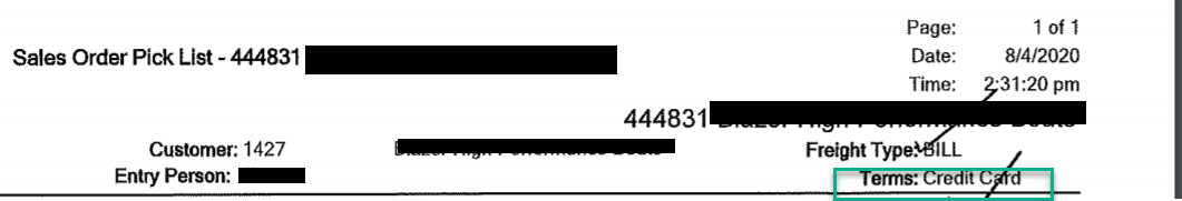

We are seeing inconsistencies in a linked field on the Sales Order Pick List. There are 2 fields that are having this issue. The terms description and ship via. The terms code will appear on some pick lists and others the terms description will appear.
It it linked on the OrderHed Table to the Terms table. The only field that is selected from terms is the description.
Any ideas what could be causing this?
SSRS 1
Is it possible that they are two different report styles? The first one has the “Freight Type” and “Terms” labels bold but they are not in the second one.
I think that might just be an artifact of the zoom level when each screen shot was made.
@rebeckagreene -
Are you sure there isn’t another Terms code like CC2, with Description: "CC" ??
What does the Order Tracker show in the Terms field for each of those two orders?
You win! That is what it was. I will be deleting old versions of this report since you can’t make them inactive anymore.
Thanks for pointing out the obvious. I think I may need more coffee.
