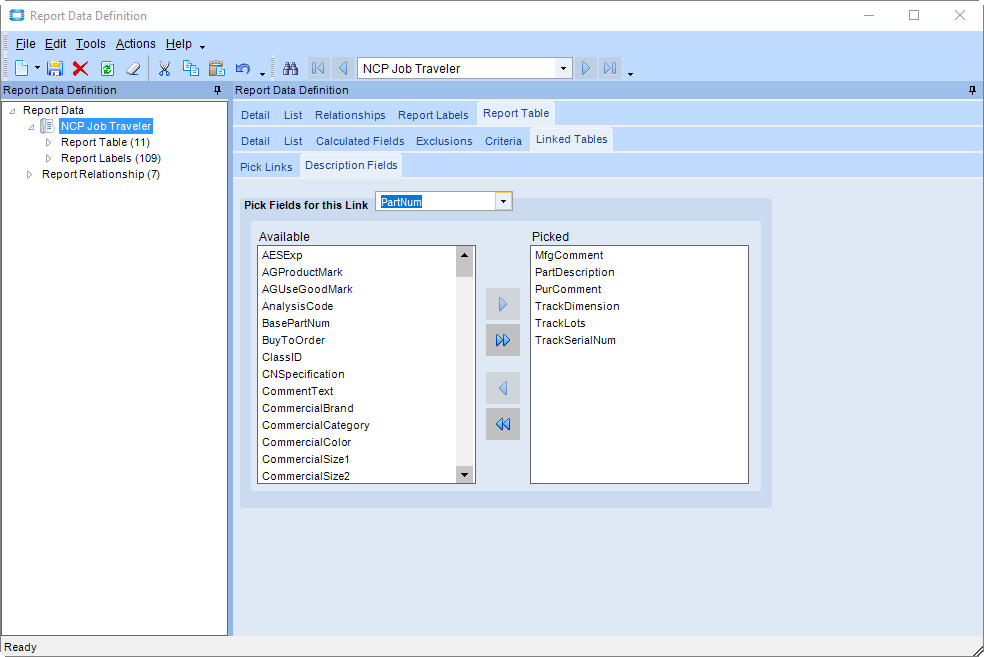

I am trying to join the Part Table on the JobMtl table in the JobTrav Report data definition. After I add the table and create the relationship the report runs extremely slow and the grouping is way off.
I am joining it with the company and partnum fields so I don’t see why I would get duplicates especially since the jobmtl table is joined to the job by jobnum so for every material there should only be one part number based on that join.

The Part table is already linked in the RDD through Linked Tables on JobHead. Just add the Part fields you want to the Picked List…
Be sure you are joining to the material part number and not the job parent
part number. I believe both are in the job material table.

@bmgarver @BoostERP What I don’t understand is the Pick Links, how can I see what they are joining to? A PartNum as a Pick link to the Job head table to me would mean that it is joined to the Part Num on the Job Head. I am looking to join the Part table on the Job Mtl table. The JobMtl table also has a pick link to the part table, but when I choose additonal fields the report starts duplicating data. I would expect it to behave the same since it is the same join…
Why does data start duplicating just because I add another field from the pick link table?
Not sure if this applies here but how many warehouses do you have? If more than one, each part that is available in multiple warehouses may be duplicated.
This will happen if there is more than one Material Part tied to the job. May need to add a group to the SSRS report grouping by MtlSeq field.
@bmgarver I made a group on the material sequence earlier and I was happy, but as soon as I ticked the “show sub assemblies” as a print option when printing the report then all of a sudden everything ran SUPER slow and the grouping fell apart.
