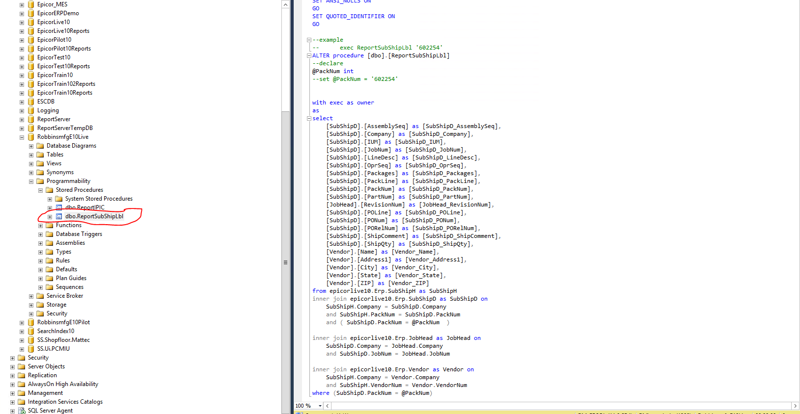

So i made a new report and created a new Stored Procedure to create a dataset from.
The picture above shows that im currently using the @Packnum parameter to check my work, but the parameter i need to use to get Epicor to work with this report is the @TableGuid. Does anyone know how i can add this parameter to my report? Any information would be great.

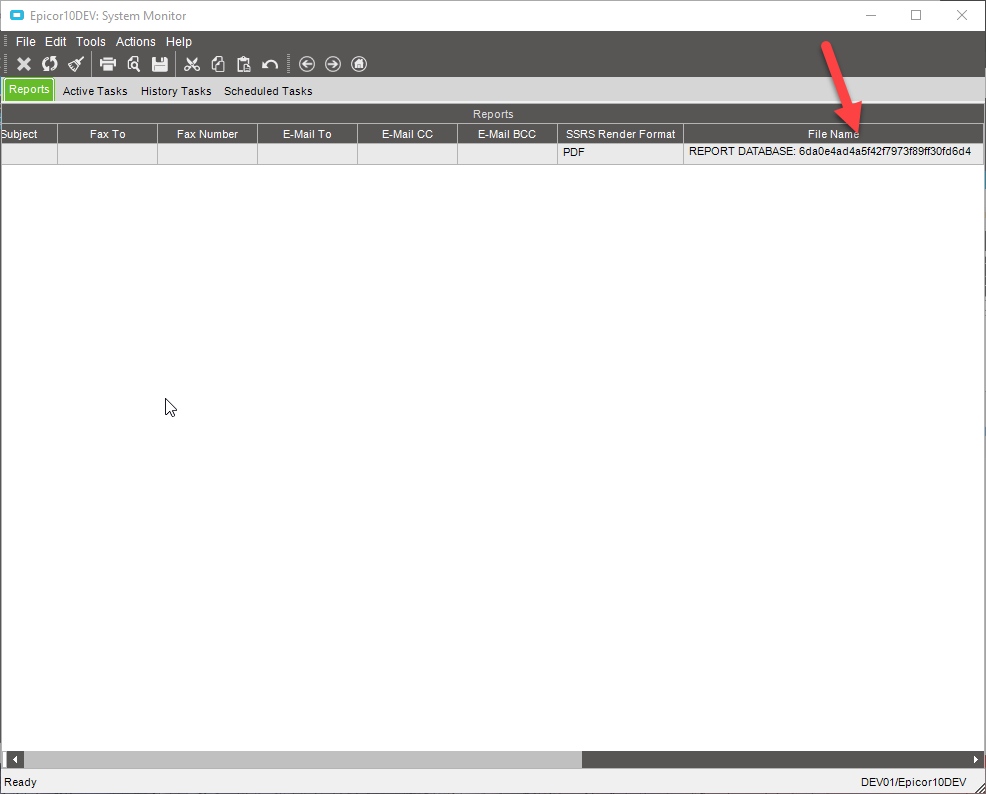

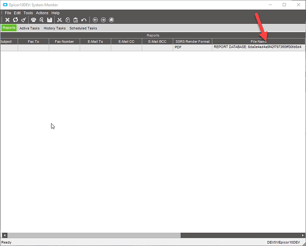

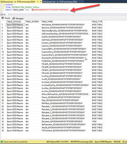

When the report data is generated, the GUID for that report is stored in the Report Database. It seems to create a table for the report data, and the table/view is named appropriately from the source (I think this is from the sub report).
Here’s a report I just generated:
Depending on the archive period, this should contain the data related to that report.

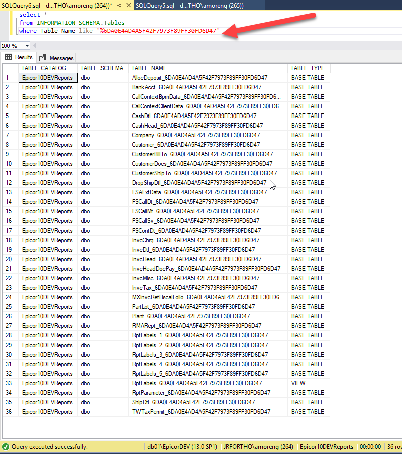

If you query Information_schema in your db, you’ll find all the tables and views created for that report
I don’t think I answered your question, but maybe that helps to understand what Epicor is doing to gather the report data…

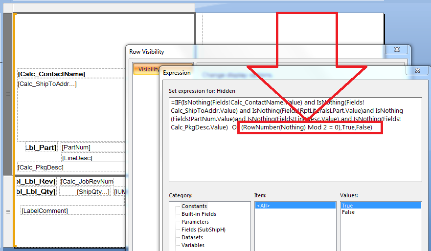

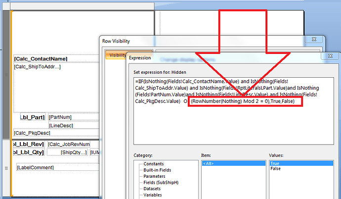

Mr. Trevor: That Label uses two separate Tablix. Each row on the label uses a “Mod function” in a formula to have the left tablix show only even rows and the right tablix shows odd rows.
Remove the visibility formula from all your rows and the label will behave the way you expect.
