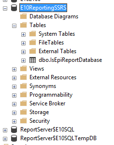

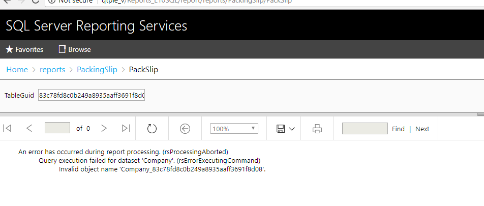

I’m having an issue to show my report in Report Builder. I have copy the value in the System Monitor > Reports Tab (the row only appears after the report renders) > FileName column.
After import in, I have given an error, and when I looked at my SSRS temp table there is nothing showing, is that correct? If not, what am I doing wrong?
Thanks in advance.
Did you specify an archive period > 0 when running the report?
Thank you Dan! that solve the issue!!!
When you run the report, set an Archive period different from the default. The default of 0 days runs the report and then removes the data tables. Set archive to 1 day, and it’ll stick around longer.
