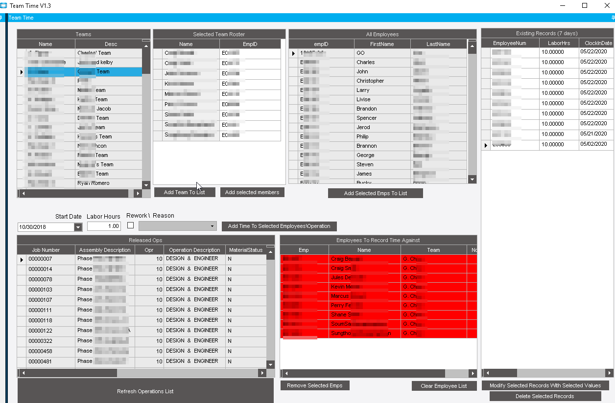

I’ve done a custom like this for a customer. I started with a UD table to build the “team”. My custom form allows customer to build/edit teams. Then they can select an entire to team to record a labor entry against. Aside from the team building, you only need a LaborAdapter.
In my case I was creating an actual labor entry, not just a clock in, but same general concept.
