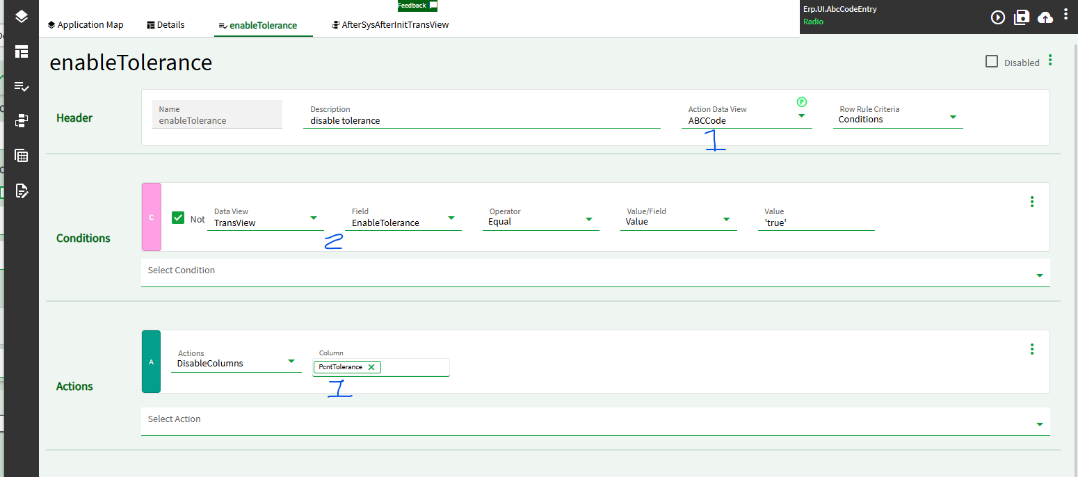

Disabling is typically done with Rules. So we need to know:
1 - DataView.Column to disable
ABCCode.PcntTolerance
2 - DataView.Column.Value to bind radio and condition the rule.
TransView.EnableTolerance
Our rule will look like this:

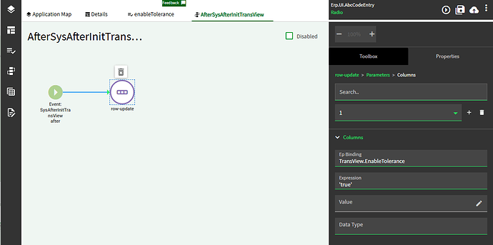

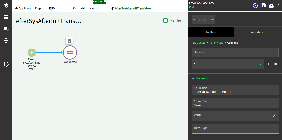

Since we’re using a custom column on TransView, let’s initialize it.
Trigger > Event > After > SysIntitTransView
row-update > TransView.EnableTolerance > Expression: 'true'
note the single quotes in both the rule condition and row-update - radio button seems to only do strings. make sure we’re not comparing numbers booleans, etc.

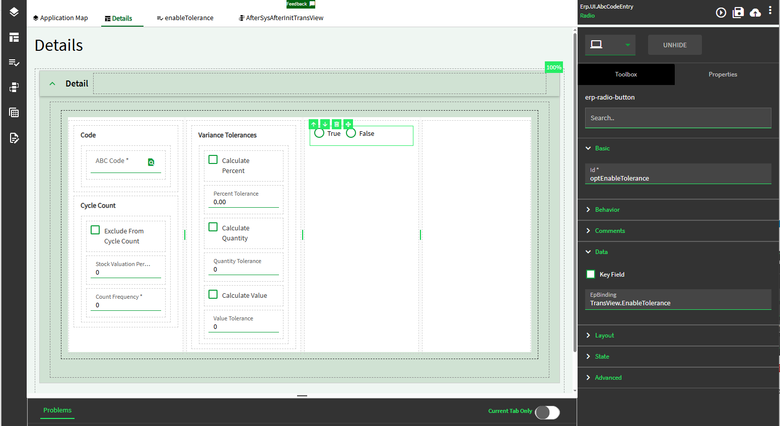

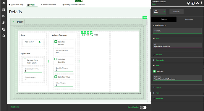

Now we need our radio buttons
epBinding: TransView.EnableTolerance
and now the radio options
Advanced > Data > add True:true and False:false
note: no single quotes in radio options, again string is assumed here. I had trouble with 1/0, true/false until I noticed that.

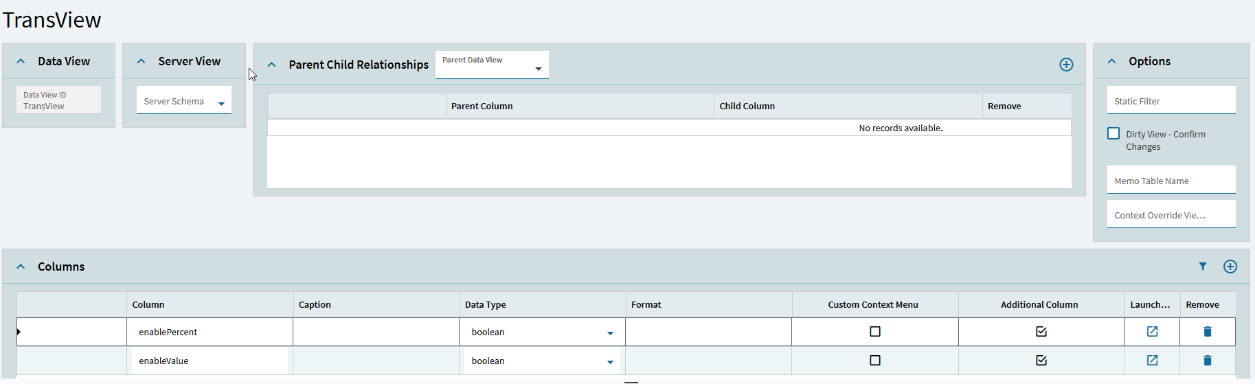

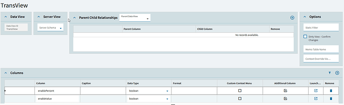

This is what I currently have setup in TransView
These are the textboxes I need to enable/disable

Unfortunately there’s no enable action in rules only disable. So you’ll need a separate rule for each textbox.
Notice ABCCode.PctTolerance (#1) in my example is the epBinding dataview field (database field) of my textbox. Rules apply to all components bound to the dataview fields in actions. You’d substitute your own in each rule respectively.
Question, is your intent to make it either-percent-or-value? Meaning when one is enabled the other disabled? If so, you still need two rules but can use the same epBinding field for your radio conditions, one for true and one for false. Also if so, you’d want one radio component having two options rather than two radios That way the value toggles between percent/value
So think of rules applying to the data table of your textbox not necessarily the dataview of the condition fields driving the rule. TransView in my example was just a place to bind the radio value since I had no other field. You could bind it to any field including one that persists in the database if available.
