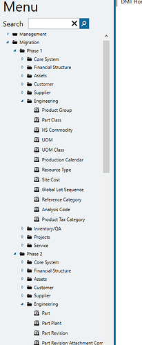

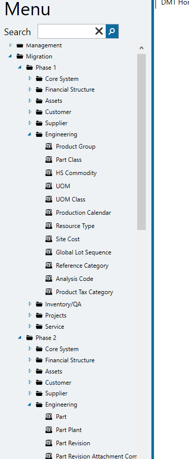

In terms of a checklist, if you have the DMT tool, the engineering sub menu within the migration main menu provides a logical breakdown of the data to be loaded.
Not all is required (e.g. Global Lot Sequence, Reference Category), but if you go through these data items and read the supporting documentation, up to and including phase 4, you should be at the stage where you can create a job and understand the data behind it.

I would go through the DMT list and see what has been set up at a company level.
