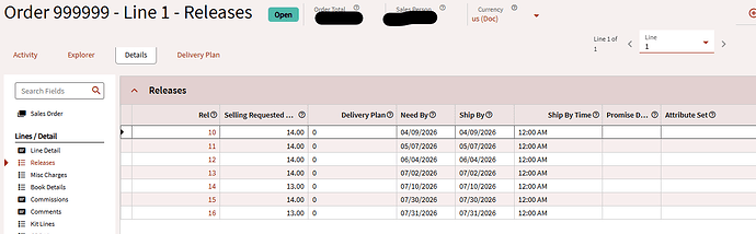

I am close with these results. I setup a part with two detail parts. Top part is the G01, with P01, and P02 as the detail parts. I added sales order demand to match the customer’s request:
These are all firm releases, not make direct.

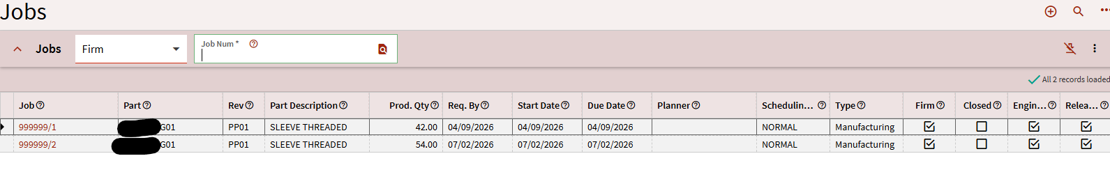

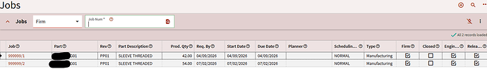

Based on this demand, I pretended that management created two top-level jobs to fulfill the demand.
The first job 999999/1 covers the first 42 pc of releases, and is set due to the earliest release date 4/9/26. The second job 999999/2 covers the last 54 pc of releases, and is set due to 7/2/26.

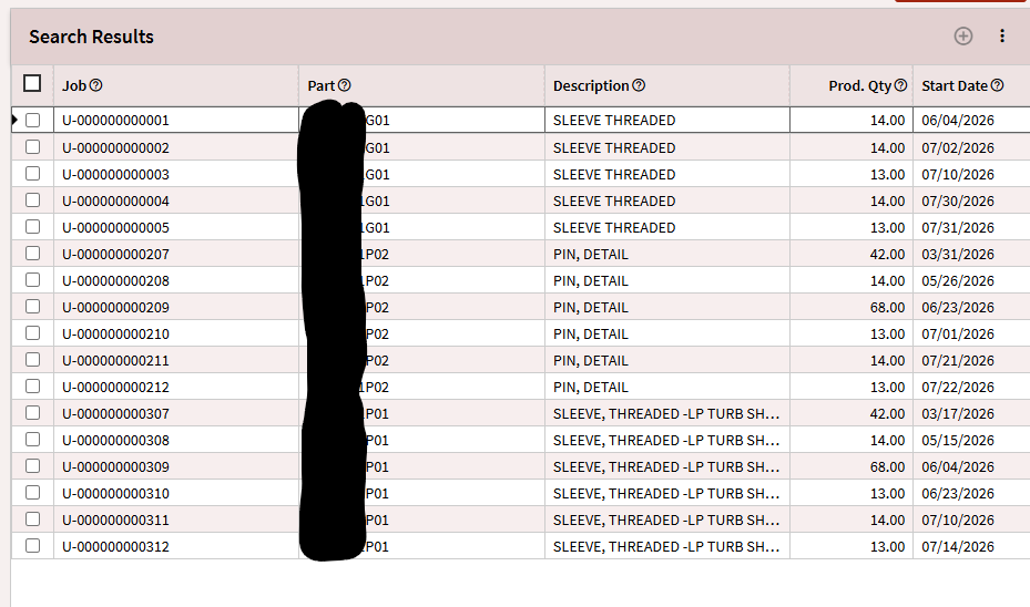

Now I run MRP for just the top level part. It suggests some jobs. Here looking at just the jobs related to the second top job, 999999/2. For 54 pc, it should suggest two jobs for the P01, and P02 parts. It does suggest the jobs, but the quantity is off by and extra 14 pcs. It should suggest the jobs at 54 pc each, instead of 68 pc each. That quantity of 14 is the amount of a single release. So MRP is combining something here, but I can’t tell why.
Here you can see the complete list of suggestions from MRP:
What can I show to help prove why the suggestion is +14 over the demand amount? What can I change to make sure the suggested amount matches the demand amount?

I am not sure why MRP is still suggesting top level jobs for U-000…1-5. The demand is set to not make direct. So I would think it would not try to create jobs for each release.
Ah! I forgot to set my top part to non-stock. Once I did that, MRP suggested exactly the right jobs (plus a bunch of extra stuff I have to ignore). I am concerned about setting that top part to non-stock, as we do sometimes need to stock the part if we make extra. How can I keep this top part as non-stock = false, but also have MRP suggest the correct quantities?

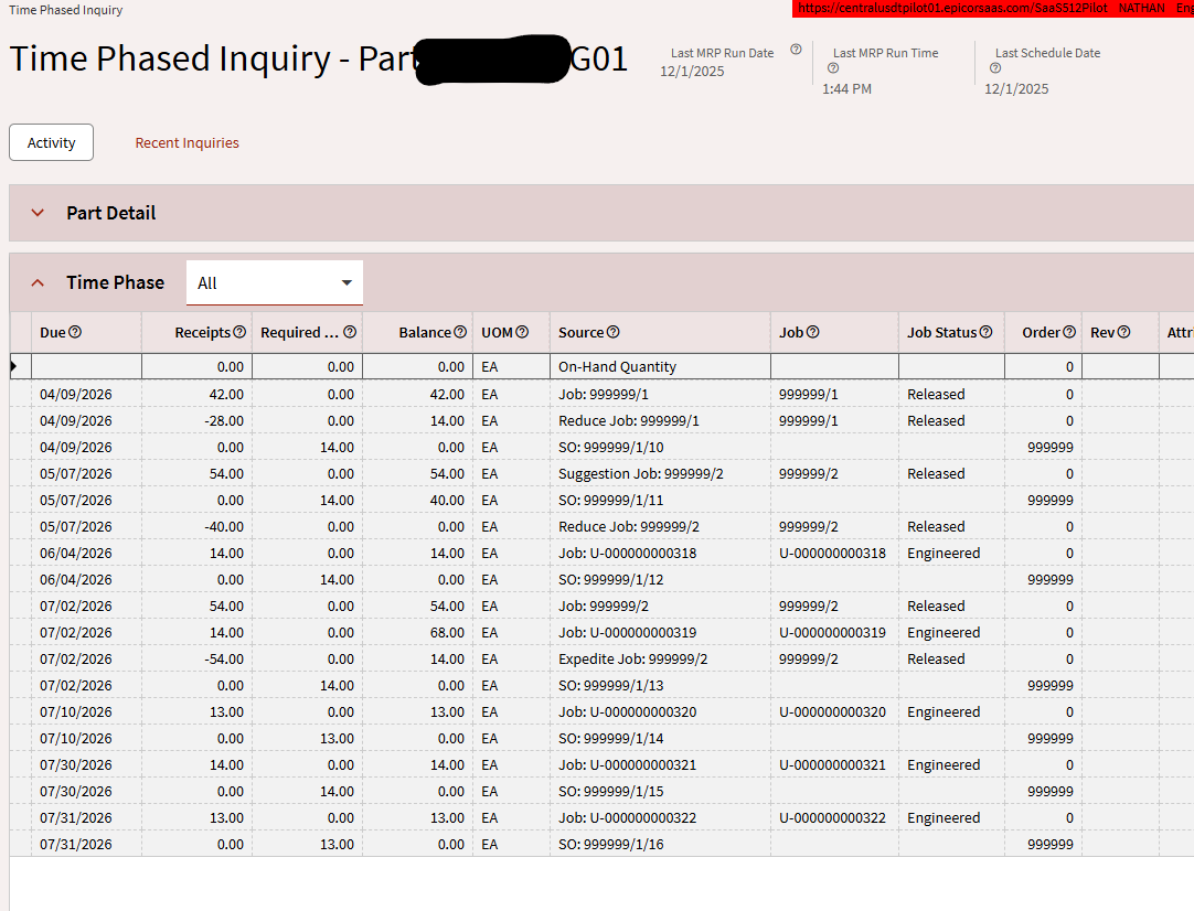

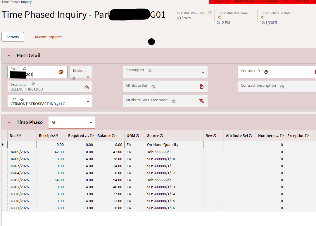

What does Time Phased Inquiry show for the top-level part with non-stock false (where you had the extra 14 pieces in suggestions)? That should help narrow down where MRP was coming up with that quantity and will show any make direct vs pull-from/ship-from stock discrepancies.

I went back and set top part to non-stock = false. Then reran MRP. Now it still suggests the correct amount:

You will want to mark Lock Quantity on the manual jobs you created (99999/1 and /2) so that MRP does not try to reduce the job and replace it with the new U- suggestions. MRP is a just-in-time system and it sees that you’re making “too much” “too early” on those manual jobs, so it’s trying to reduce those jobs to meed the immediate need and then make new jobs for the subsequent releases.
