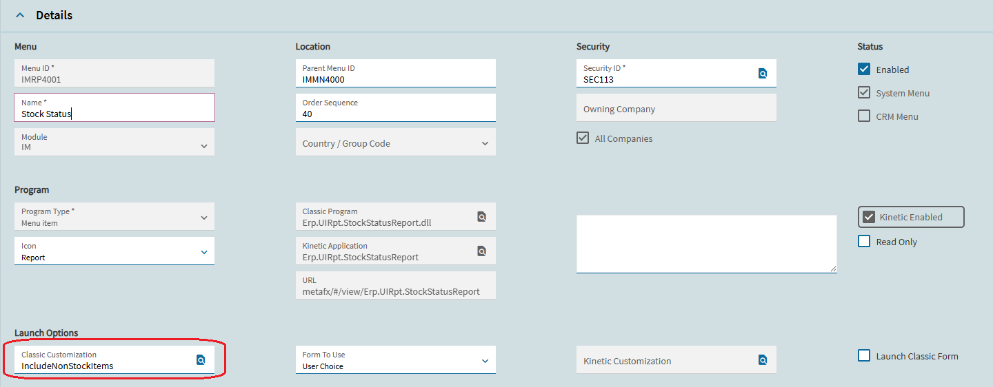

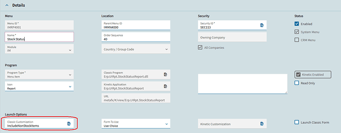

Below is my Kinetic menu setup if it helps at all.

I found the issue. This particular report has a customization on it. I didn’t even think to check for that. Removing it solves the issue and the dialog will now launch as a Kinetic form vs the classic UI dialog.
