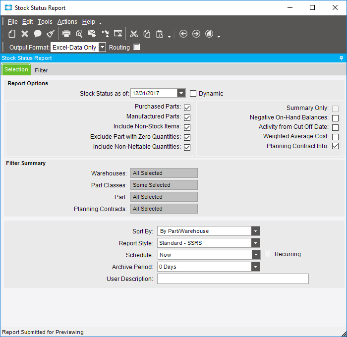

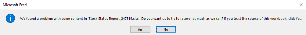

When running the Stock Status report for the part class RPMT in the Main Plant, it will not run in Excel, only PDF. All other part classes run in Excel just fine as best I can tell. Can you please take a look and see why it won’t run in Excel?

It looks like the message is referring to an already existing ‘Stock Status Report_247519.xlsx’ that is sitting out there somewhere? Maybe in the \EpicorData\Reports\Username\ folder? I wonder if you can find the location of that specific (247519) report and rename it or delete it and then will the Stock Status - Data Only report run for you? Maybe there was something wrong with that report when it was closed out and Excel still has a link to it and is still trying to recover it upon the opening of the Excel program or the generation of the report…?

What if you chose just the “Excel” option as the Output Format instead of “Excel-Data Only”?
Can you see anything in your System Monitor under the Reports or History Tasks tab? An entry that you could highlight and click the Print Preview for and does it give you any additional error message?
