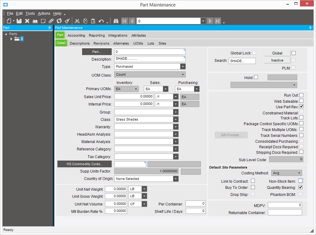

Are two parts marked as “Non-Stock Items”?
 ![](https://epiusers.help/uploads/default/original/2X/a/a3fc2f8a5790a7667b1148a88ca7132b0bb67f08.png)
![](https://epiusers.help/uploads/default/original/2X/1/1d11be5ae0f2ff2dd6c2888aaa2aac5773188437.png)

@E102016- No, the part is Quantity Bearing part…I have already cheked with non-stock option on Stock Status Report form.
