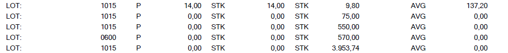

# Stock Status Report showing bogus lots **Category:** [Epicor ERP 10](https://www.epiusers.help/c/e10/5) **Created:** 2016-11-01 16:13 UTC **Views:** 659 **Replies:** 1 **URL:** https://www.epiusers.help/t/stock-status-report-showing-bogus-lots/36048 --- ## Post #1 by @Mark_Wonsil We are launching tomorrow and have loaded our inventory and the numbers look good in total but there are these occasional lots of zero quantity with random costs from other parts displayed. We are on 10.0.700.4. Loaded quantities with DMT using Quantity Adjustment. Attached a clip of the report. Thanks!!! Mark W. --- ## Post #2 by @Mark_Wonsil Self-inflicted. There were multiple PartPlant records in the DMT. Carry on, nothing to see here. --- **Canonical:** https://www.epiusers.help/t/stock-status-report-showing-bogus-lots/36048 **Original content:** https://www.epiusers.help/t/stock-status-report-showing-bogus-lots/36048
