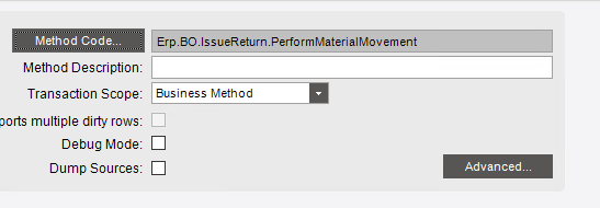

I’ve started writing a BPM that will stop the shop floor from issuing material on a closed Operation. I did a trace and saw it was the IssueReturn BO and then said If TranQty changes from any to another, invoke Op BO. However, the IssueReturn doesn’t have the Op Number in it, so I can’t connect them.
Anyone have a better idea to get this done? I am thinking I may be going at this backwards.

I think a method directive approach is usually best. Which is the last method that submits the data to perform the “Issue”?
The method is IssueReturn. IssueReturn doesn’t have Related Operation.
