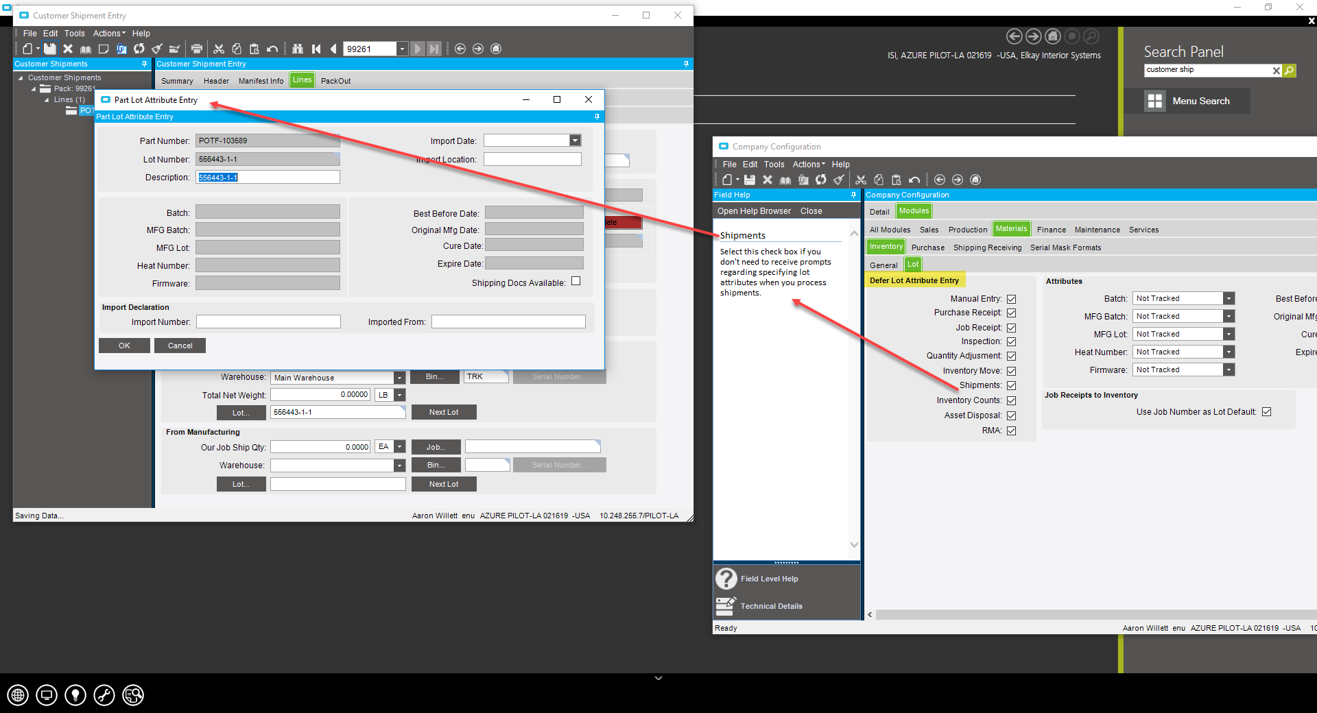

Anyone know how to prevent the “Part Lot Attribute Entry” screen from popping up?
I have the checkbox marked in the company config to defer it, but it still pops up when I enter a new lot in shipment entry.

The more I read into those fields, the more it seems like it defers the fields marked as “Tracked”, not necessarily preventing the entire popup.
Yes these fields are basically to defer the entry to the stage in the checkbox. So you have to decide the point at which you want to enter them.
Vinay Kamboj
Alternatively just try with the only manual entry checkbox checked, leaving others unchecked. The field help says the following:
Manual Entry
Select this check box if you don’t need to receive prompts regarding specifying lot attributes when you enter a lot.
