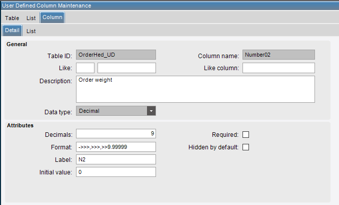

If the BPM is creating/altering the value in the UD field and does the Number04 field have a default value of 99,999? It could be that the math is failing, and the default value is not getting overwritten by the correct value.
Specifically where clearing the cache makes the problem go away? Or just the general problem of the bpm context data getting overwritten.
As I’ve described above, I can’t conceive of how Number04 getting overwritten would produce what I’m seeing - for that theory to work, then there must be some OTHER order in the system where the weight calculates to 99,999, and all these other orders are somehow accidentally calculating the weight for that order instead of the correct one, yet somehow updating the UD field for the correct order number? It doesn’t make any sense.
Im with you because if your Number04 changed then it would have updated the total for the wrong OrderNum. I am not sure, what could be the culprit. If you are using the Kinetic UI maybe there is some Angular/JS form bug with it. If you are using the Classic, I’ve never seen it. Stumped for sure.
The first step in the post processing directive is to set the value of the total weight variable to 0, the idea being that if the calculation fails, then the order weight should still get set to zero.

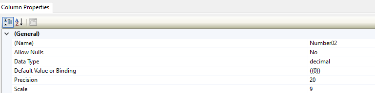

I don’t see that there is a default on that column in the table but I don’t know if there could be a default somewhere else that I’m missing?
Yep
The order weight never calculated properly before either (when we were using classic) but at that time it was being done with UI code, so its hard to compare as the two things changed at the same time.
Out of curiosity on the Kinetic UI, what do you have your input box set to, does it have a format setting. Feels a bit as if it is setting the format/mask as the value, 99,999, or does it also set the value in the database? (then I guess we can rule out a input)

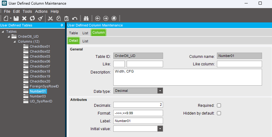

True - sorry if I missed that earlier. As for default value, UD Column Maintenance and Extended Properties can contain a default Init value (from when you created the column.
