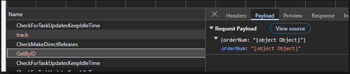

  • Open a PO in PO tracker (po must have a line associated with a sales order)
  • Go to line, right click and open associated SO in sales order tracker.
  • Open a different PO in PO tracker (po must have a line associated with a sales order)
  • As soon as the SO entry gets the broadcast data it triggers the getbyID which seems to be sending a bad data.
  • If I hit shift + refresh on the PO tracker tab it re-broadcasts the data and the SO screen picks it up successfully.
I tried the same idea with quote, opening different sales order through the context menu but it didn’t happen that way. It seems very strange the broadcast works once, but not the second time, and it only seems to happen on this screen combo that I have noticed.

I just followed your steps in my 2025.2.10 test system and am not able to replicate the results, mine seems to work without issue.
I do have custom layers on both screens and one of those customizations forces the removal of the landing page so I am not sure if that is a variable in this difference on top of just a completely separate install.
Just to clarify, you open ONE PO Tracker (not two separate ones) and do an Open With Order Tracker, then change the PO you are looking at and instead of it refreshing Order Tracker as expected you get the error? Another question, in both cases is the linked order linked to Line 1 of the PO, in my test both are linked to Line 1 (we do very little Purchase to Order so I only have one supplier I know I can open to test without making orders up)
That is all correct. There are multiple lines connected to the sales order, but I think in every case I tested line 1 was for sure.
