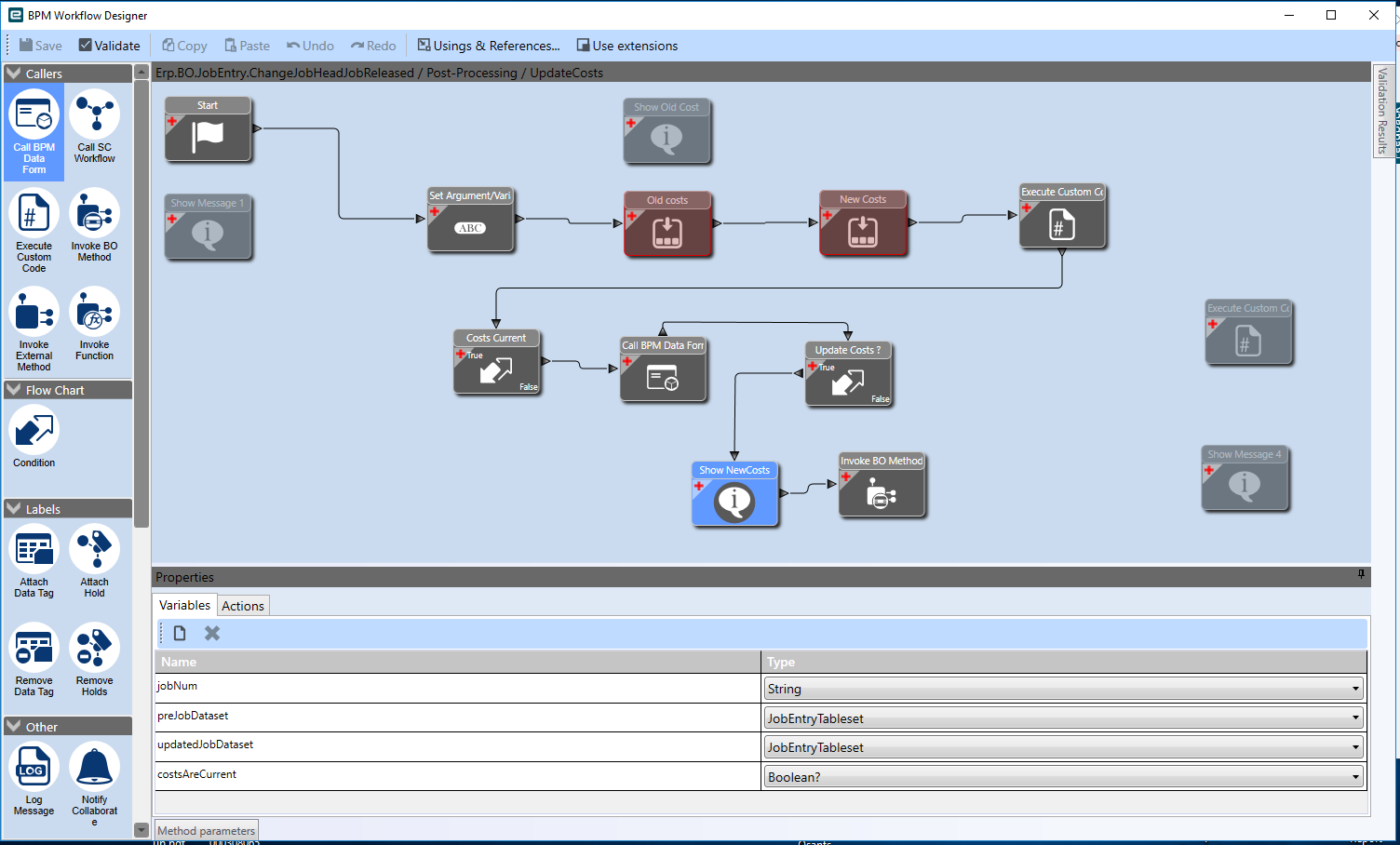

self update…
Wound up using fill table by Query collecting the Materials from JobMtl. Filled 2 whole datasets, dsOldCosts and dsNew Costs. I am guessing it may not be the most efficient but I am slowly making progress…
Working on comparing the 2…
Dean
IMO - good move, my initial thought when reading your post was to ditch the code and use the widgets in the BPM to query for each material’s part costs and call the update method. Haven’t done this, but you being Public Cloud the widgets are the best way… IMO.
Thank you Rick,
I have used code blocks before, with the change to Datasets away from TempTables, It feels like the syntax/structure has changed. That’s what I was struggling with initially. I created 2 datasets, 1 filling the ds.JobMtl from the ERP.JobMtlTable and the 2nd from the same table with a join to ERP.PartCost to get the costs( binding StdMtlCost+ StdLaborCost etc) to the EstUnit cost of the dataset. I then used a codeblock to loop through the 1st ds,JobMtl and look for the same MtlPart in the 2nd ds and compare the EstUnitCost. aal goes well from there.
When trying to use the code originally posted, it was like the dsJobMtl was empty…
Dean
