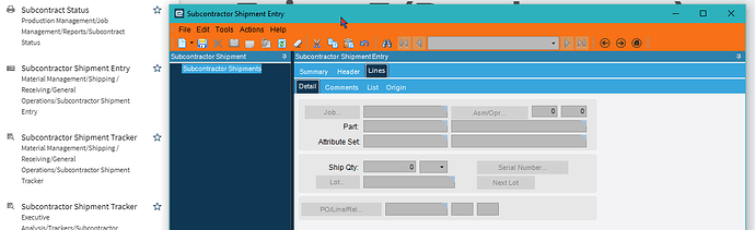

Been a while and now I implementing another site. Anyway good information. Have one more question. Our buyers would love to see the list of materials that are sent to the subcontractor on the PO with the part numbers and their quantities issued to the job. I figure maybe we could do something in the comments but there seems to be no way to include in the comments field. Also want that same information to transfer to comments on the subcontract pack list. Any ideas, back in the days we just sent a copy of the job traveler with the packing slip.
There are some screens to create shipments to send to suppliers. This would be where you could keep track of what you sent to them.
I’m trying to remember what prints on the Subcontract Packing Slip that gets sent with the shipment to the subcontractor. It’s been a while since I’ve worked with it. The material gets issued to the job. There was a way to print it because we had to do that along with Lot numbers so the supplier could keep the order straight (it was possible to have more that one PO out to them for the same parts that belonged to different jobs/orders).
