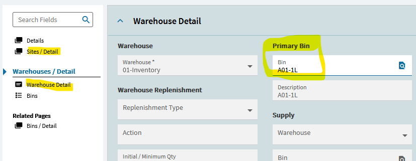

Check the Default bin in the part setup for the original warehouse. It’s located in Sites → Warehouse Detail. If there is a Primary bin listed for the old warehouse, remove it and save.
Would that control which site its being received into though? I didn’t think it was possible to receive a po into a different site than it was created in, which is why I was curious to see screenshots of the PO.
