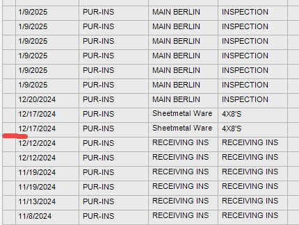

The raw material receipts are going to the correct place. This is the history for one of our subcontract parts. We switched to Kinetic on 12/14 and they stopped going to the default warehouse.
