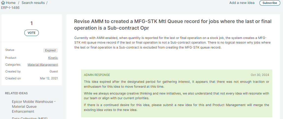

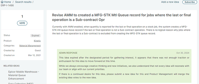

I didn’t find a solution, it does look like this is an old problem.
I found this epicor ideas post with one vote from March 2021: Log In - Epicor Identity
I upvoted it, but I’m guessing a new idea needs to be posted on there too.
thank you
Oh that is a good shout!
If I get time today, I will submit it as an idea. It would be very handy to be able to manage subcontract receipts like job receipts…
Took me a while, oops… but idea now logged
Create an MFG-STK Material Queue Record where the final operation is Subcontract | Epicor Ideas Portal
