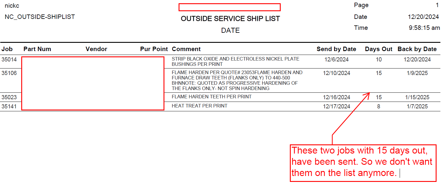

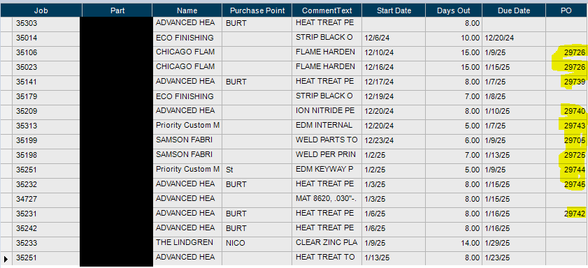

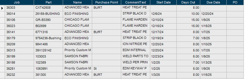

Here is what our list currently looks like -
Any ideas on how to take jobs off that list that have an open PO for that subcontract sequence? I’m probably missing something obvious.

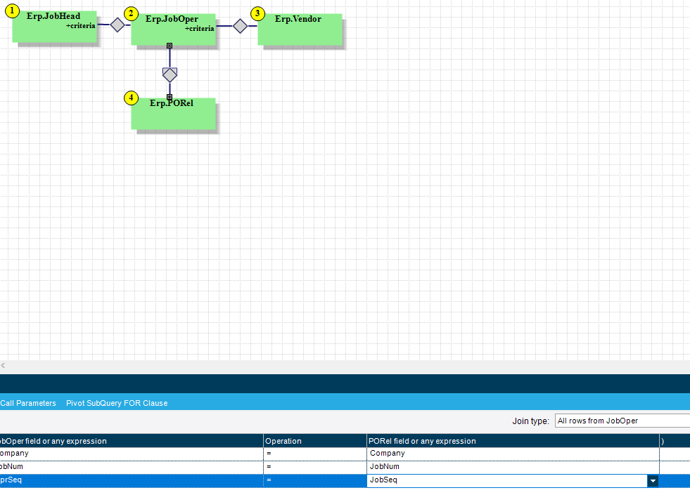

But if you do an outer join,
you should maintain all JobNums whether they have a PO referenced against them or not.

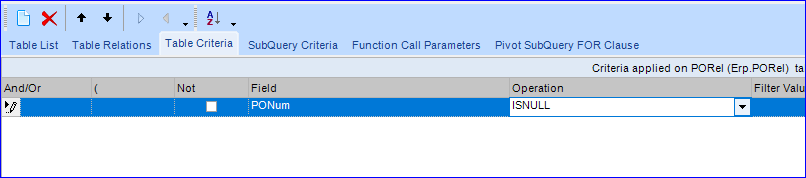

Click on your PORel table… add a Table Criteria of: PONum ISNULL
Try and see if that works. It should only return rows where PONum is empty.

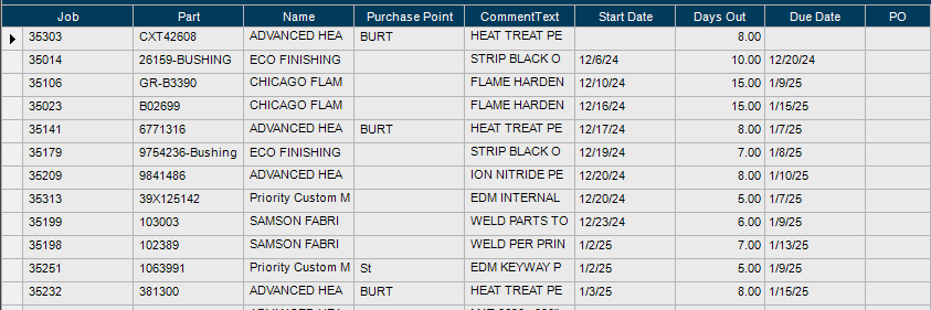

Here is the report before adding PO is null

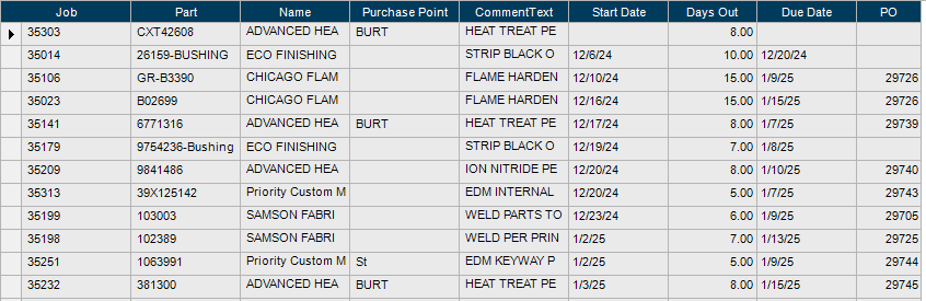

Here is after -
It essential just got rid of the PO #'s.
Any ideas?
Change the join on PORel:
back to an inner join
When I do that, no rows return in the BAQ

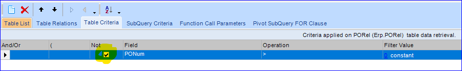

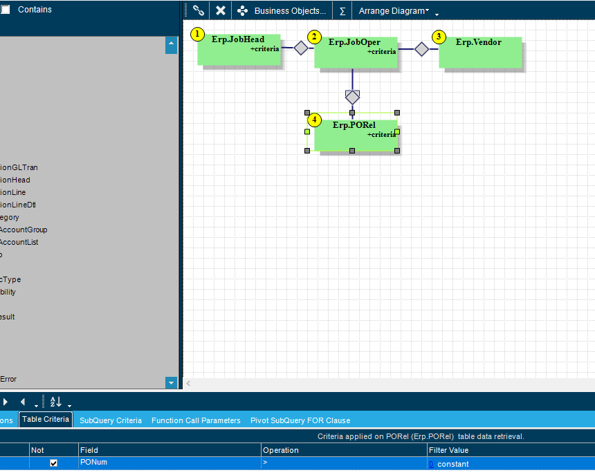

Then try this criteria:
Don’t miss that NOT checkbox.
So, we only want records where PONum is NOT > 0.
This for some reason, still returns all the rows… Hmmm

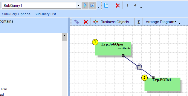

SubQuery:
(ignore the table criteria on JobOper… I was just limiting it to one job so test with).

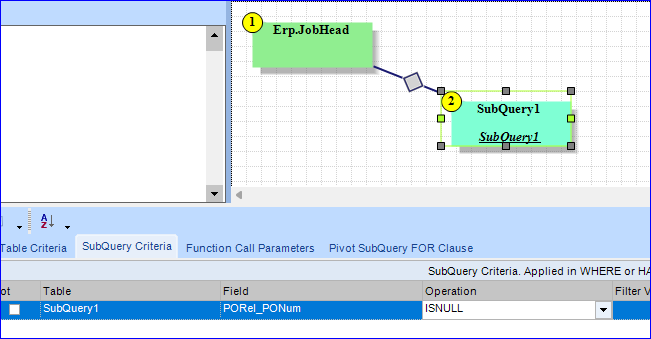

DO Need the Subquery criteria which we tried before as a table criteria:

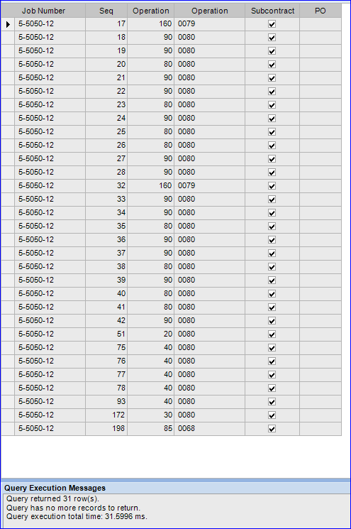

With the subquery criteria:
31 rows on this job

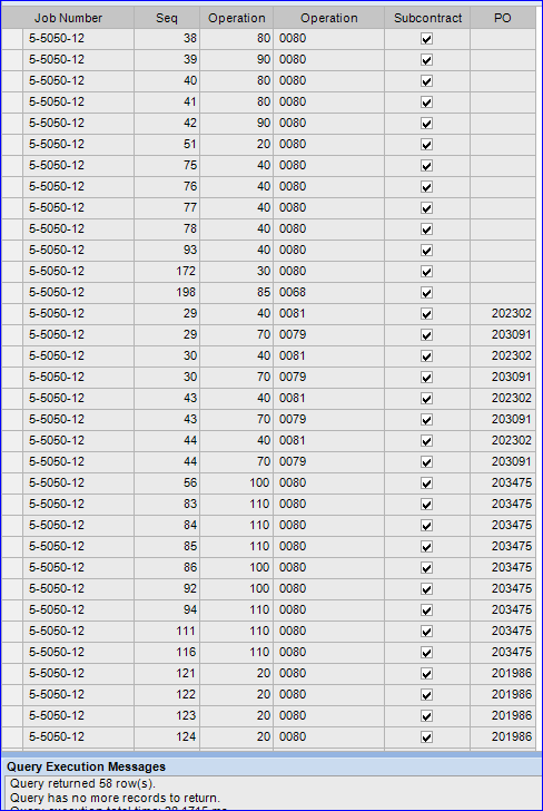

Without the subquery criteria… I get 58 rows and PO Nums start appearing:
