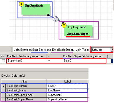

In a BAQ I would usually add a second instance of EmpBasic table
e.g.
I didn’t even think about that! Wow! I’m gonna try that.
